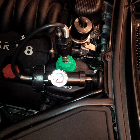

I bought this one from Harbor Freight, it's the green adapter. You must have the wrong adapter for yours.
Jeff - Just to confirm - that green adapter works with the XK8? I only ask because the owner's manual they have online for that one says the green adapter is for GM... if it works for the xk8 then I will definitely pick it up
I went out to the garage to check, yes the green one. I see the confusion, the manual says #17 Green = GM. However the green one is marked #21 which isn't even in the manual. Good thing I don't read manuals, I write them.
