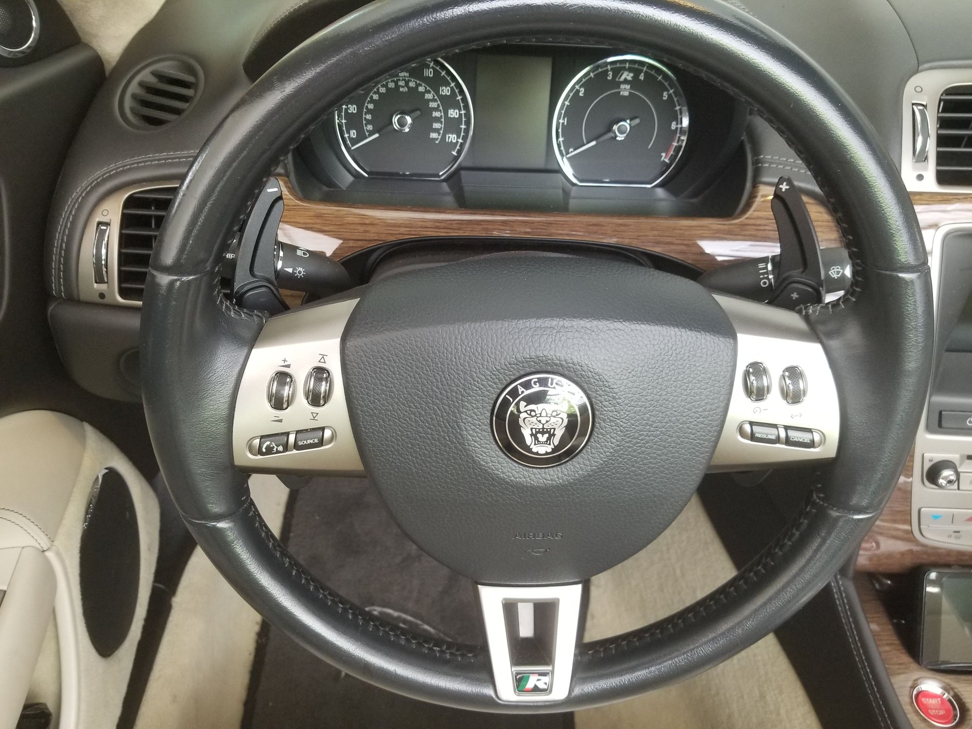

Alas, the full zoot XKR-S I'm cueing to rebid on doesn't seem to have it (1 wheel on RH spoke; 2 on LH spoke): https://bringatrailer.com/listing/20...uar-xk-r-s-10/

For the North American market, Adaptive Cruise Control was standard equipment on all 2010 XKR models, the first year of the 5.0L engine. ACC was also standard equipment on the 4.2L 2008 XKR Portfolio models together with the Alcon Performance Brake Package. ACC was an available option on other models for $2,200. Unlike the 2008 XKR Portfolio, ACC and Alcon Brakes were not standard equipment on the 2009 XKR Portfolio. ACC cost $2,200 and Alcon Brakes cost $5,000.
Models with ACC are easily identified by the two rotary controls on the right side of the steering wheel. Non-ACC models have one rotary control. Here's mine:
