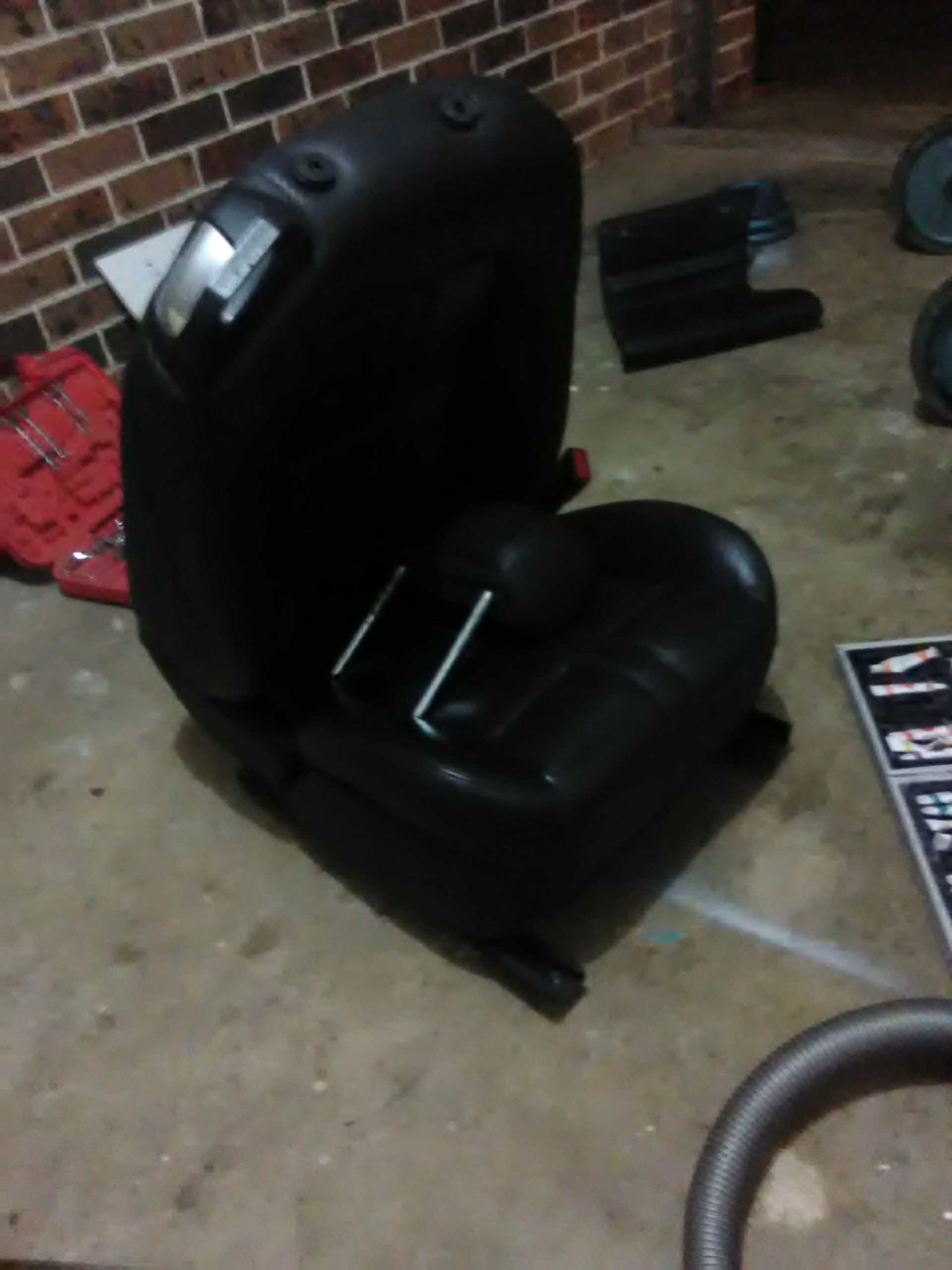

A further reduction in weight could come from the front seats 60lbs a piece or simply lose the passenger seat on track day
Attached Thumbnails Adjustable coilovers installed, finally!-img_20190330_195557.jpg
I've considered replacing with 15 pound race seats, losing the passenger seat only would unbalance the car unless it is properly corner weighted. I've also tried driving with rear seat out and boot trim removed and the road/tire and exhaust noise inside the cabin was overwhelming.

Thats right you have the muffler delete .
It's amazing how much of the sound is simply muffled when ever I have my over night bag in the boot
Ive been thinking of a weight reduction in my xk so I'm obviously very interested in alot of the mods you have done .
15lb seats that's a hefty saving which brand are they .
I think they were Sparco but they did not include the base so that adds a couple of pounds. Still have not had time to pull one of the seats and weigh it yet. I need to do that and check CCF in SDD to see what adjustments can me made to the SRS system, if any.
