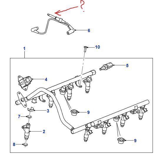

Hello forum,
I just ordered the part AJ88894 - Hose-Vacuum Outlet to replace the non-original hose currently on my XK 4.2 NA from 2007, and I have a question. One end of the hose connects to the fuel pressure regulator/sensor, while the other connects to the intake. However, I'm unsure where the second outlet is supposed to connect. Does anyone know?
Thank you.
Old Apr 14, 2025 | 06:57 AM
fritzthecat's Avatar
Joined: Aug 2014
Posts: 110
Likes: 125
From: Boca Raton, Florida
I don’t think it attaches to anything. It goes into a half-round clip and just stays there floating in space. See my post here:
https://www.jaguarforums.com/forum/xk-xkr-x150-33/question-about-fuel-trims-268793/
https://www.jaguarforums.com/forum/xk-xkr-x150-33/question-about-fuel-trims-268793/#&gid=1&pid=3
It’s a little different, cuz mine has the supercharger, but the part you’re asking about looks the same.
