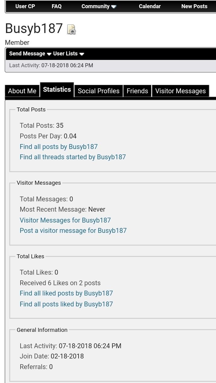

Old Oct 27, 2020 | 10:19 PM
Stuart S's Avatar
Posts: 10,113
Likes: 7,122
From: Atlanta suburbs
Wes,
The thread starter, Busyb187, hasn't made another post since 7/18/2018. I doubt that he will reply.
Stuart
From his Public Profile:
