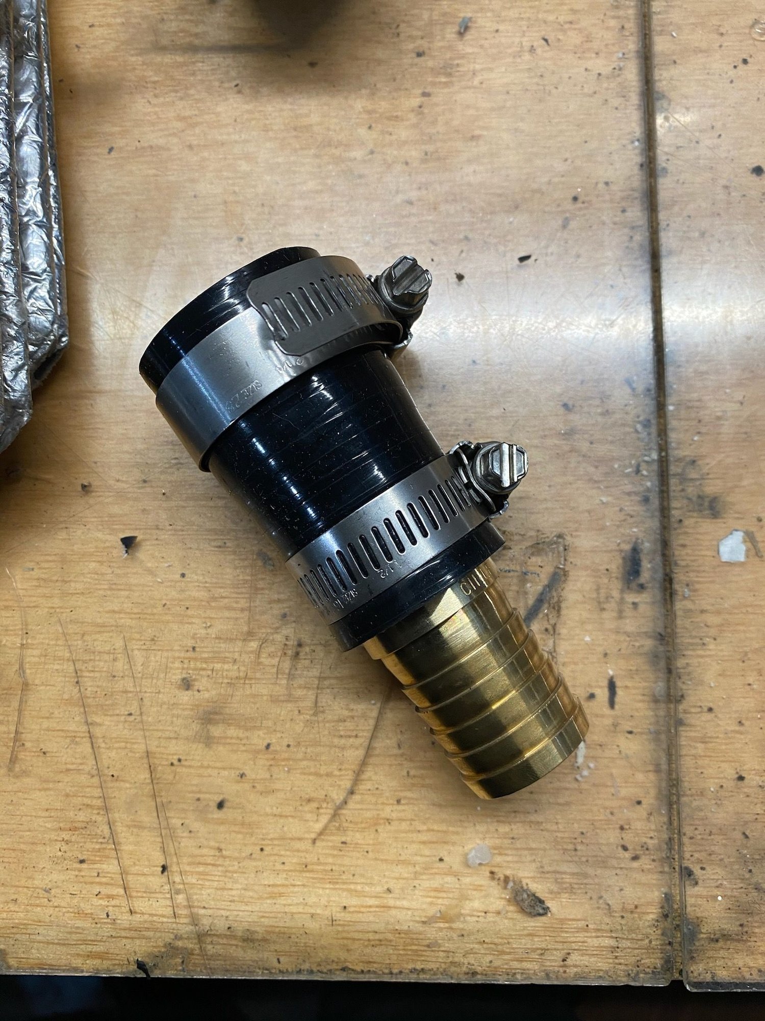

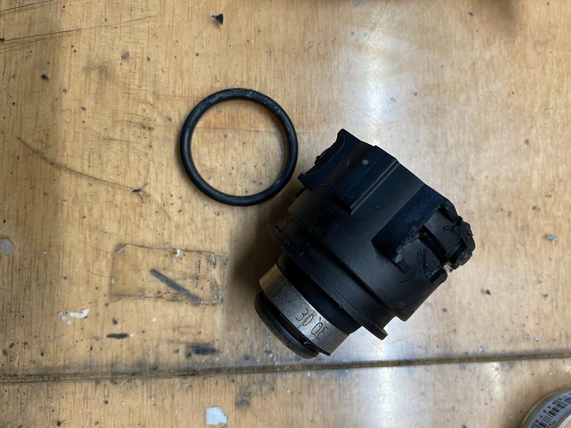

First it was some bad clamping causing hoses to tear near the S/C, then a worn o-ring on the ECT sensor, and now the latest.... worn o-ring inside the plastic housing of this hose:
A few options with this one:
- RTV and silicone wrap (this was terrible and didn't work)
- Replace the whole hose PN C2P2142 for about $80 (on back order from the motherland and didn't want to wait, also to lazy to get to the bottom clamp for the whole hose)
- Replace just the failed O-ring inside the plastic (tried this too, but could not get the right size)

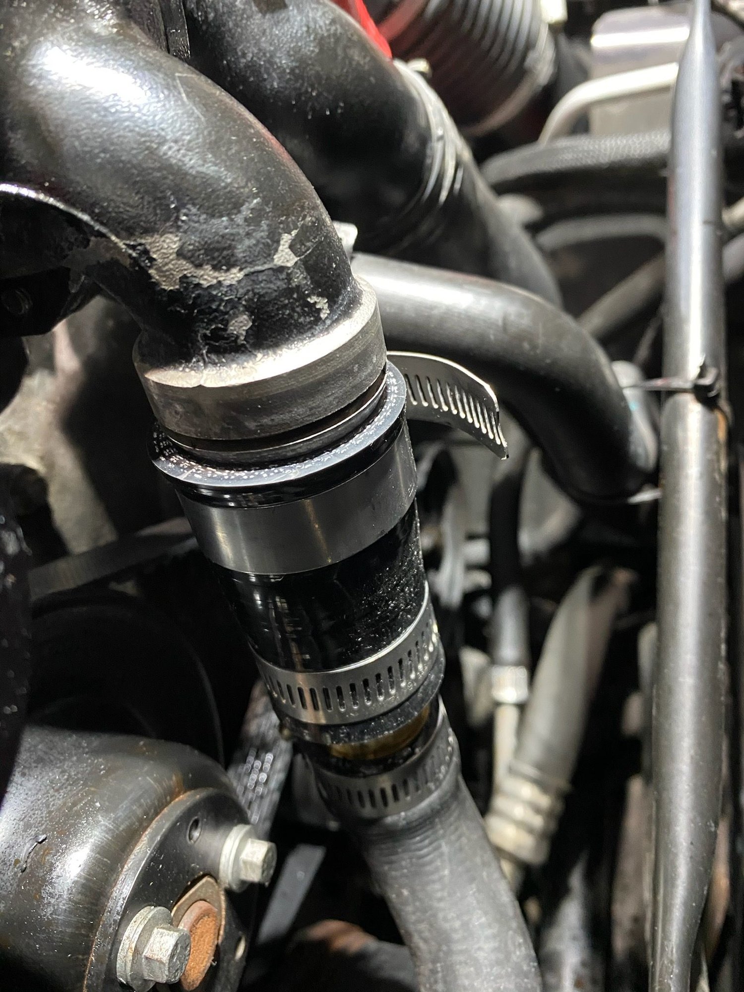

- Chop of the plastic part and replace with a 1.25" to 1" silicone reducer + 1" barbed coupler + some clamps
Last option is what you're seeing here. Eliminates the o-ring/plastic failure mode altogether.

Jaguar is Ford, and I just had to replace a seal much like your top picture on my old F-150. It took about a minute and a half to do with a factory O-ring and a screwdriver to pry the fitting unlocked. No leaks so far.

Hope theres a lip on the metal side or that thing has a chance of slowly slipping off under pressure.
Yea it would have been real easy that way, but I'm not sure where to find that exact O-ring size.
You don't think the barbed fitting is good enough? The bottom part worries me a bit but I think it should hold.

Drove 425 miles this weekend and for the first time in a few months .... coolant level didn't go down!! Let's hope it stays that way.
