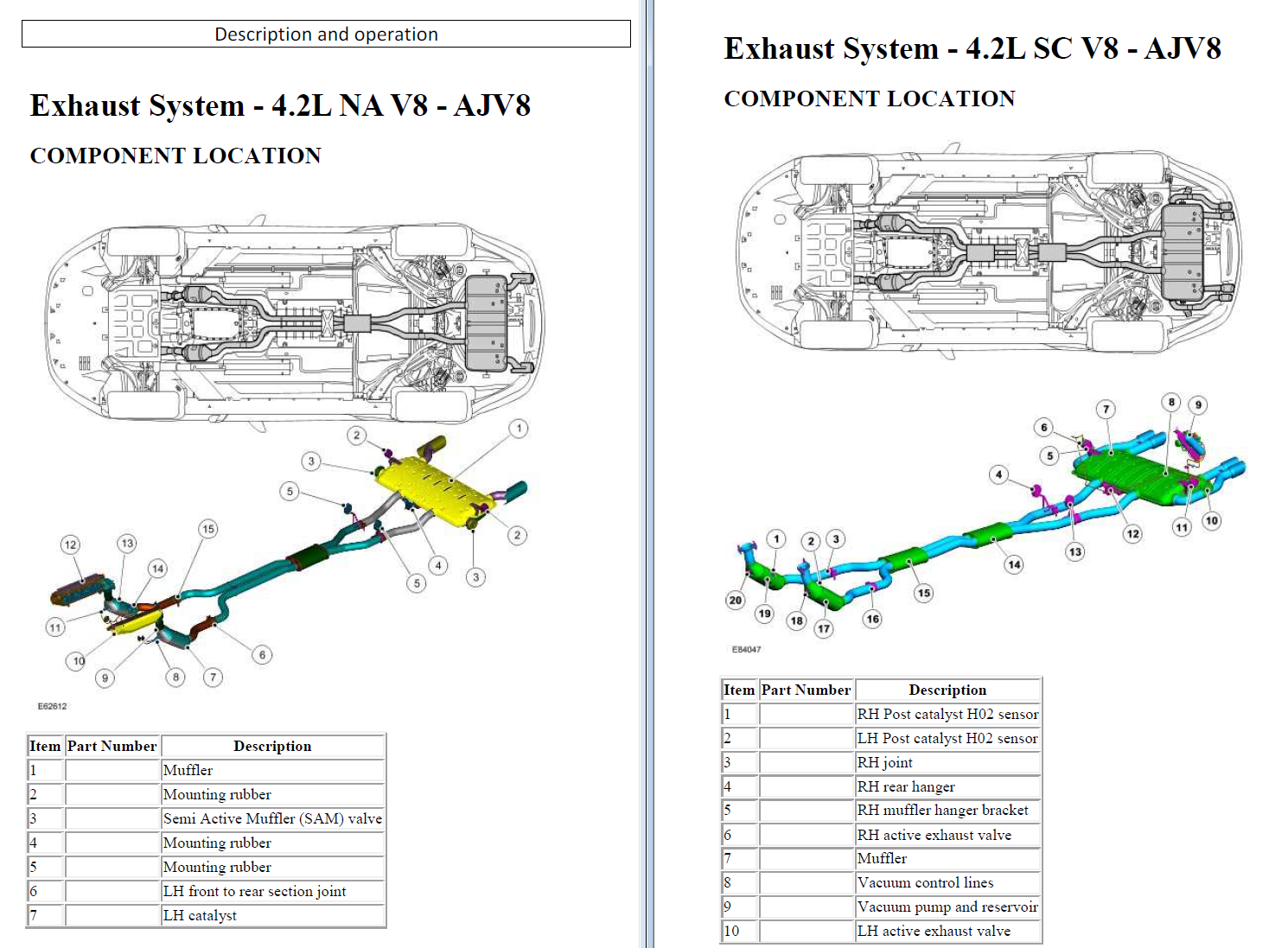

Hi guys 09 xkr , was going to do a backbox delete, ordered some nice tips .. then had the jag lifted and noticed the previous owner removed the last resonator already. I felt it was louder than stock when I bought it but still want a deeper and louder set up. my question Is anyone have the last resonator and back box deleted ? Ive seen the 2 YouTube vids of the BB delete but both have the 2 resonators. thoughts on sound with the set up im asking about.

You can look at fitting a secondhand XK midpipe which has only 1 resonator / silencer instead of the XKR midpipe which has 2 resonators / silencers?
Some people would remove the midpipe and replace it with an Xpipe and keep the original rear muffler and have it tune to suit. The Xpipe with original rear muffler will be a very similar setup to the XKRS, not identical but close enough.
