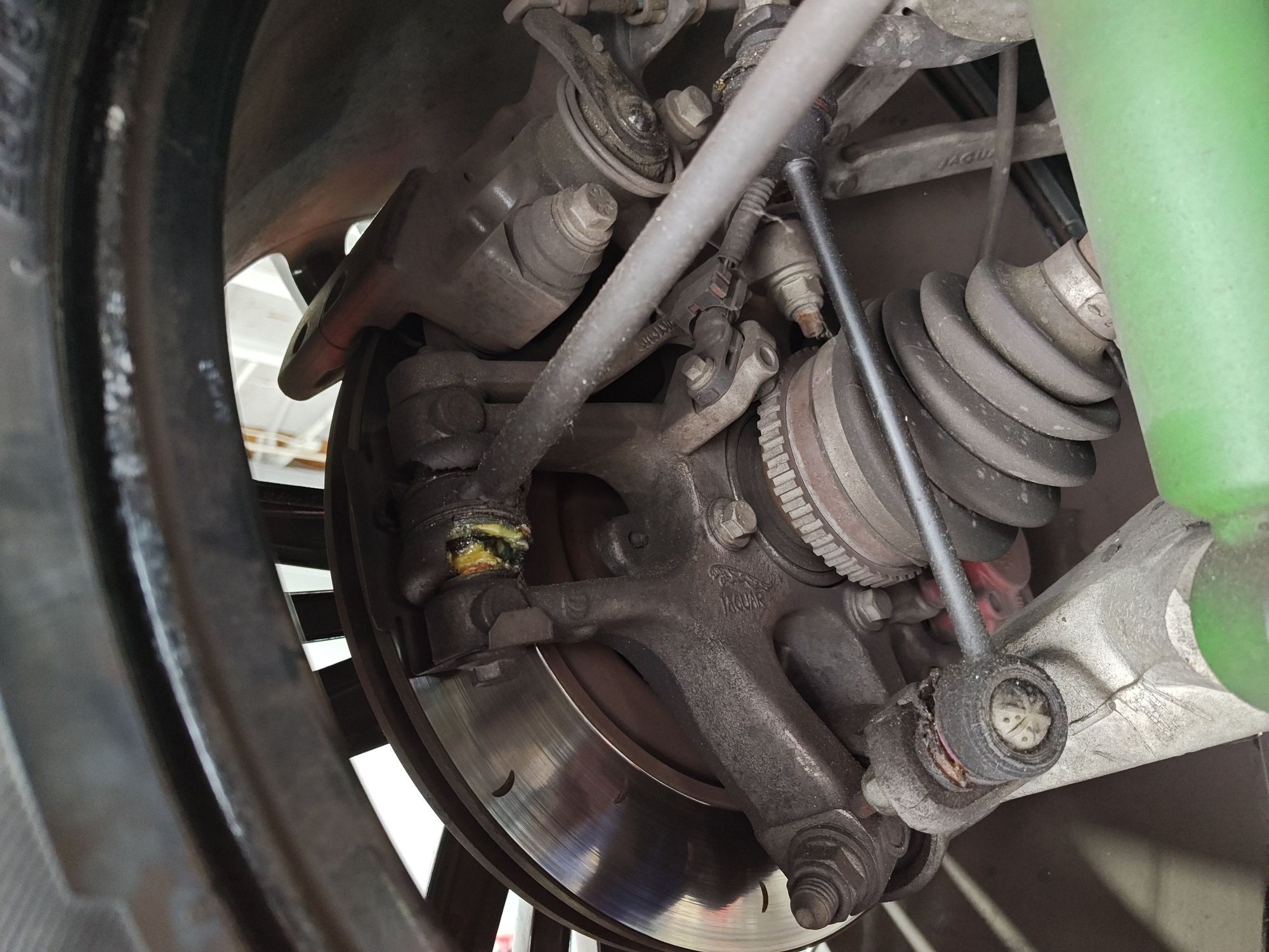

See my Suspension Replacement thread. Why pay more?
Before:
Stuart

From: Kaysville, Utah, US
I expected an "After" picture...

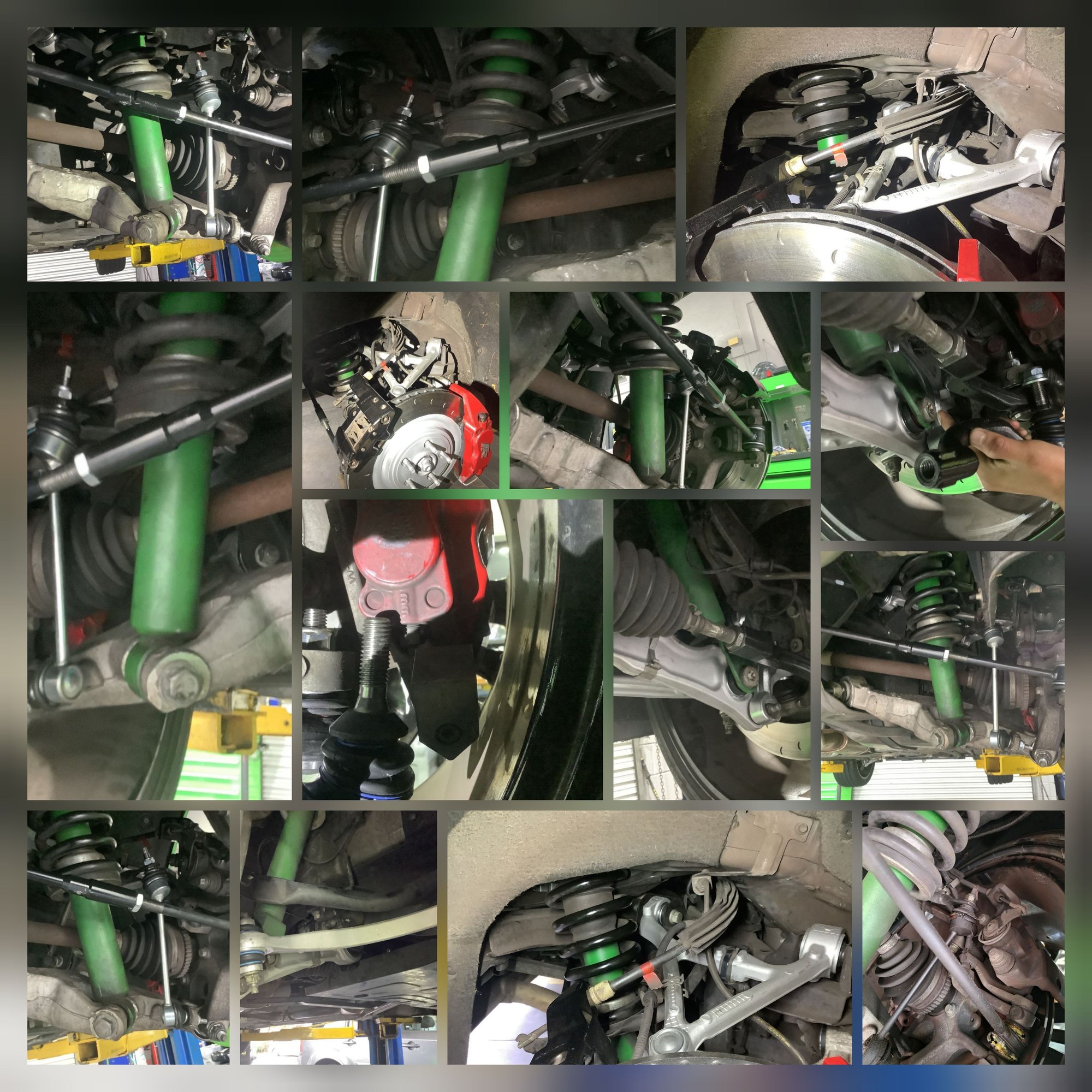

Since you asked ... Enlarge to see details.
Stuart
P.S. Let me know if you want me to post each photo separately.

Old Mar 1, 2026 | 01:20 PM

And how does the alignment look?

After my mechanic finished replacing all the suspension parts, he sent the car out to a nearby alignment shop that set it to factory specs. As I expected, it drives like a brand new XKR.
