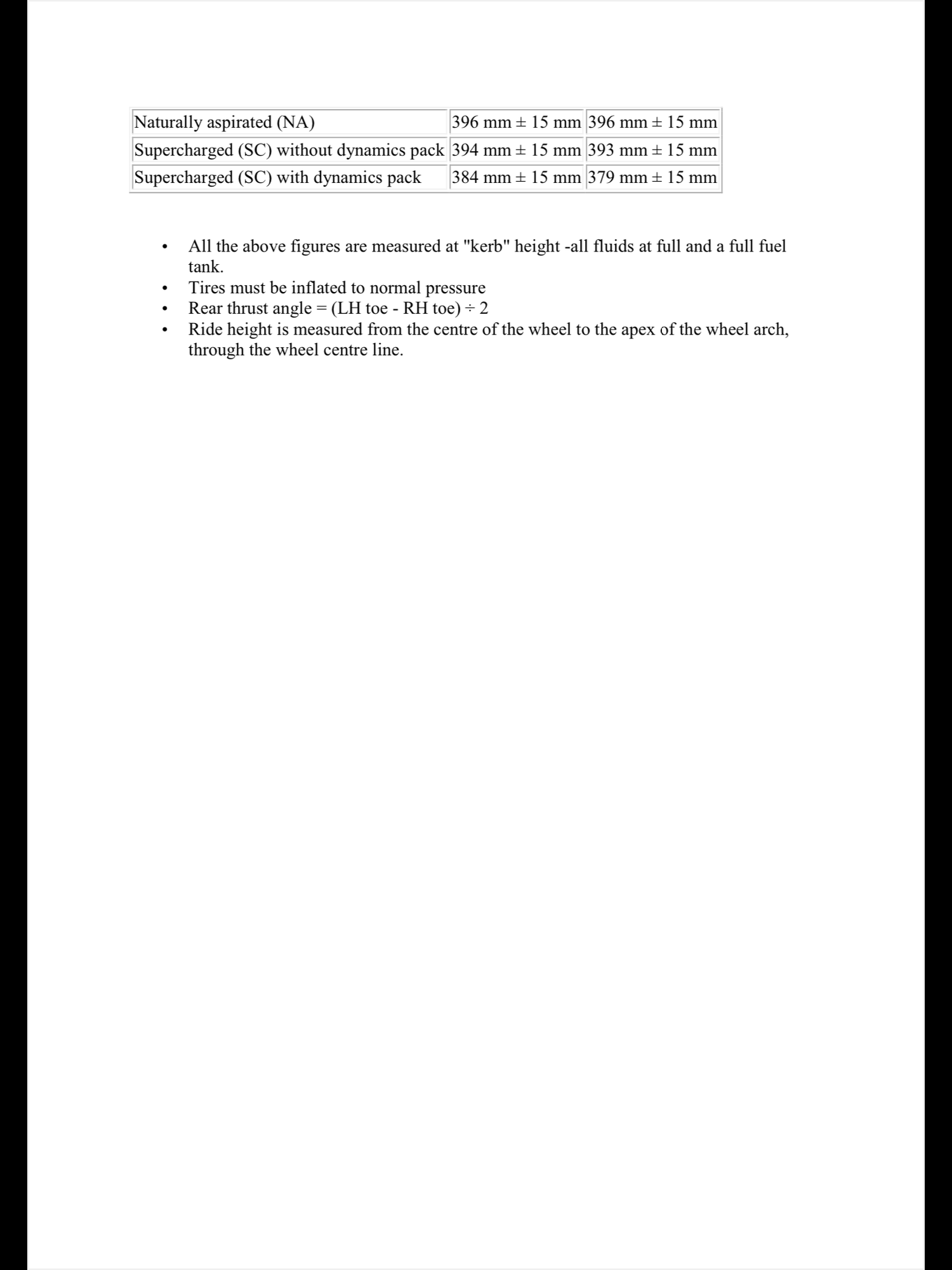

Could anyone with a 4.2 XKR convertible on 20 inch wheels, do me a massive favor and measure from the center of the wheel hub to the wheel arch on the rear please.
I’ve been rebuilding my rear suspension and need to load up the suspension before tightening all the suspension mounts and it’s much easier to do so by jacking up the hub vs fitting the discs and wheels

As per the workshop manual…
Perfect, thank you

Hello D6LC.On my 2008 XKR with 20" wheela the measuremant is 38.5 cms. I did all my suspenstion a few months ago front and back so it should be accurate.
Good luck
Regards
