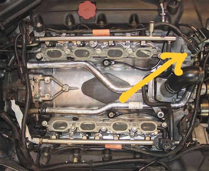

Not sure if wire harness on the 4.2 is similar to 4.0, but in my previous 4.0 the connector of bank 2 injectors into the other side wire harness (at front of bank 2 cam cover I believe) had the moist seal missing and developed similar problems as a result.
Its a while ago do hope I am right and not confused with coil harness, but checking that would make sense too I guess.

I meant this connector:

Checked it and cleaned with electronics cleaner then add some dielectric grease. It was a good connector still with red catch lock, whereas I found 2 others in area that cleaned and had to zip tie to hold 'em. Someone before me was messing up in the front - maybe hoses or water pump....
