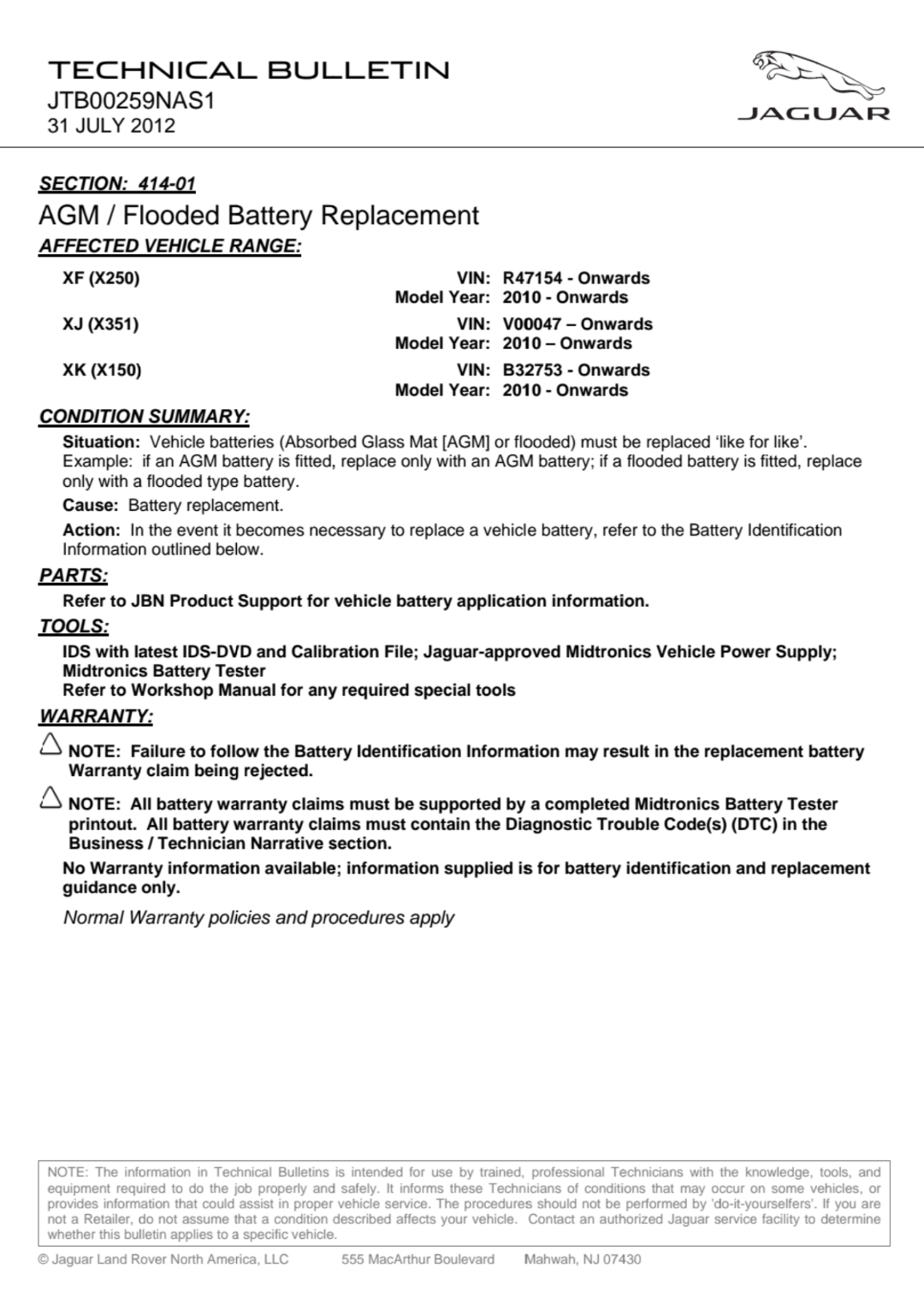

I know that many Forum members have switched from their OEM flooded (wet cell) battery to an AGM battery. I did, too. All was good until my convertible top started operating slower than usual. Switching back to a conventional battery from Costco solved that problem. I'm still using my old CTEK MUS4.3 all the time, as my XKR is not my daily driver.
Note that the alternator's charging profile corresponds to the battery type your car was born with. If it didn't come from the factory with an AGM battery, your alternator won't properly charge it.

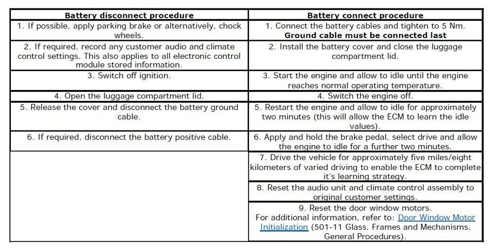

My procedure for a battery swap in my XKR:
Charge the battery overnight with a good charger.
Swap the battery (with vent attached).
Reset windows.
Eso es todo.
It's never failed.

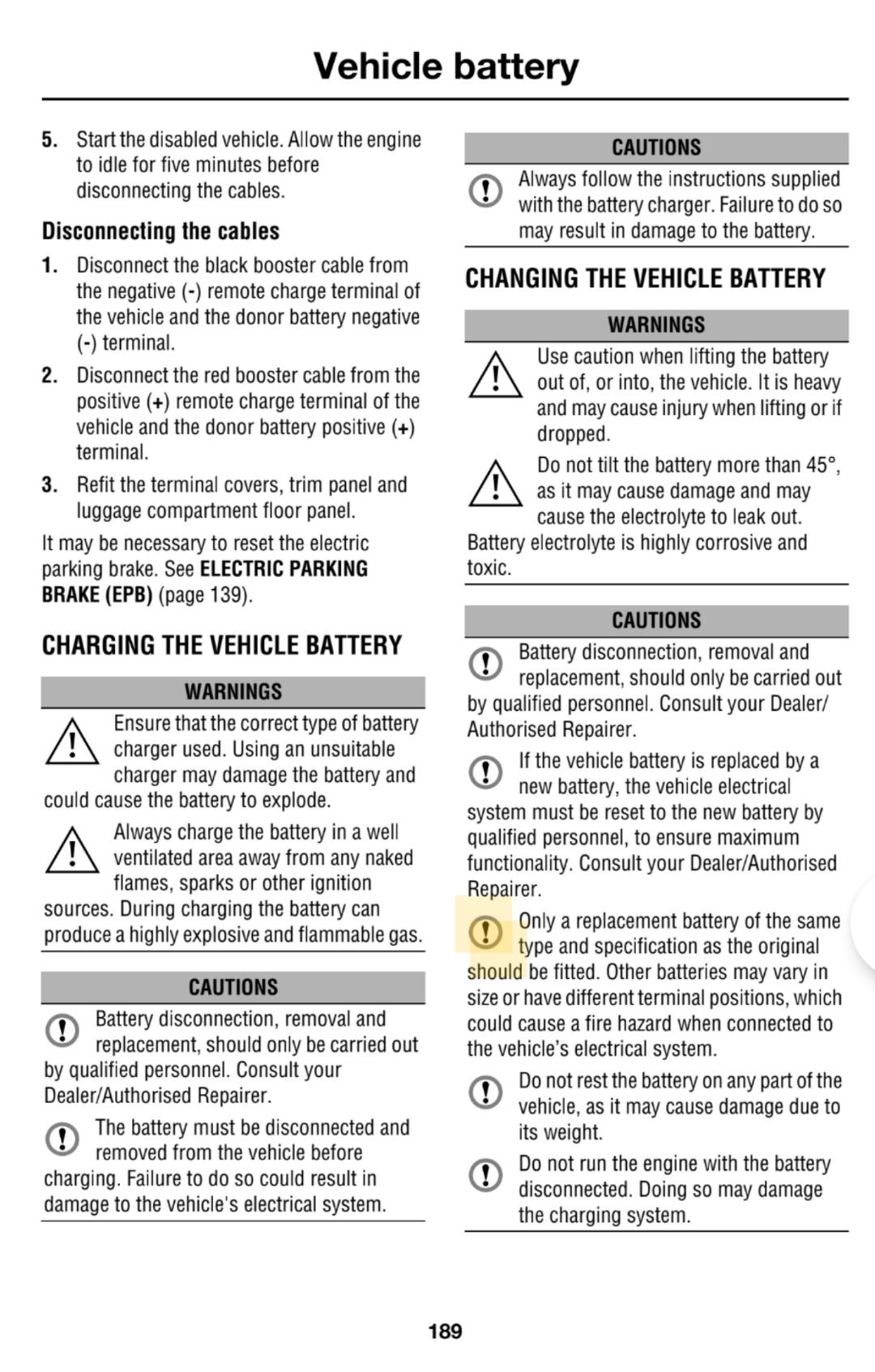

My colleague's suggestion should be followed. I would add just 1 point. Let the battery rest (not on any charging device) for 6 hours, then take a voltage reading. If its less than 12.6v, your battery is not at 100% health.
Incidentally, I now have access to my docs. And from the workshop manual...
