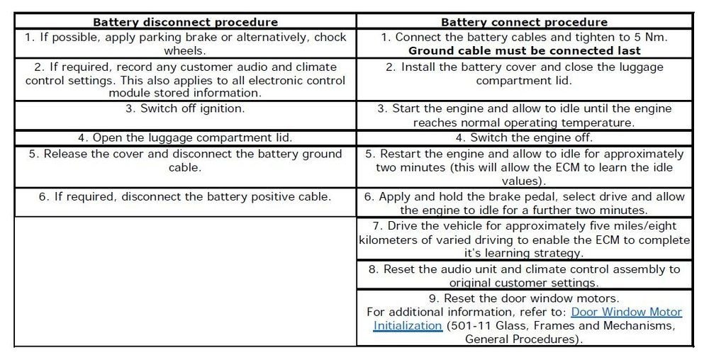

Maintaining power while replacing the battery probably fried the Battery Monitoring System module and maybe worse. You didn't follow the proper procedure:
Old Jan 7, 2025 | 03:11 PM

Hey Ed. No OBD device required. There's a bit of a dance you need to do to reset it:

^^^^ Holy crap! Who came up with that procedure?

My question is whether that procedure actually works or is someone having us on? It is April Fool's day, after all.

I've been doing it this way for the last 9 years.

..... and me for thirteen. The more you do it, the easier it gets.

Yep, done it a few times myself, failed plenty of times!
What they never tell you is that you have about 5 seconds to complete the entire sequence otherwise you lose, so I printed it out then sat in the car reading the print out and trying to memorise it before I had a bash at it. Failed the first few times but eventually got it.
