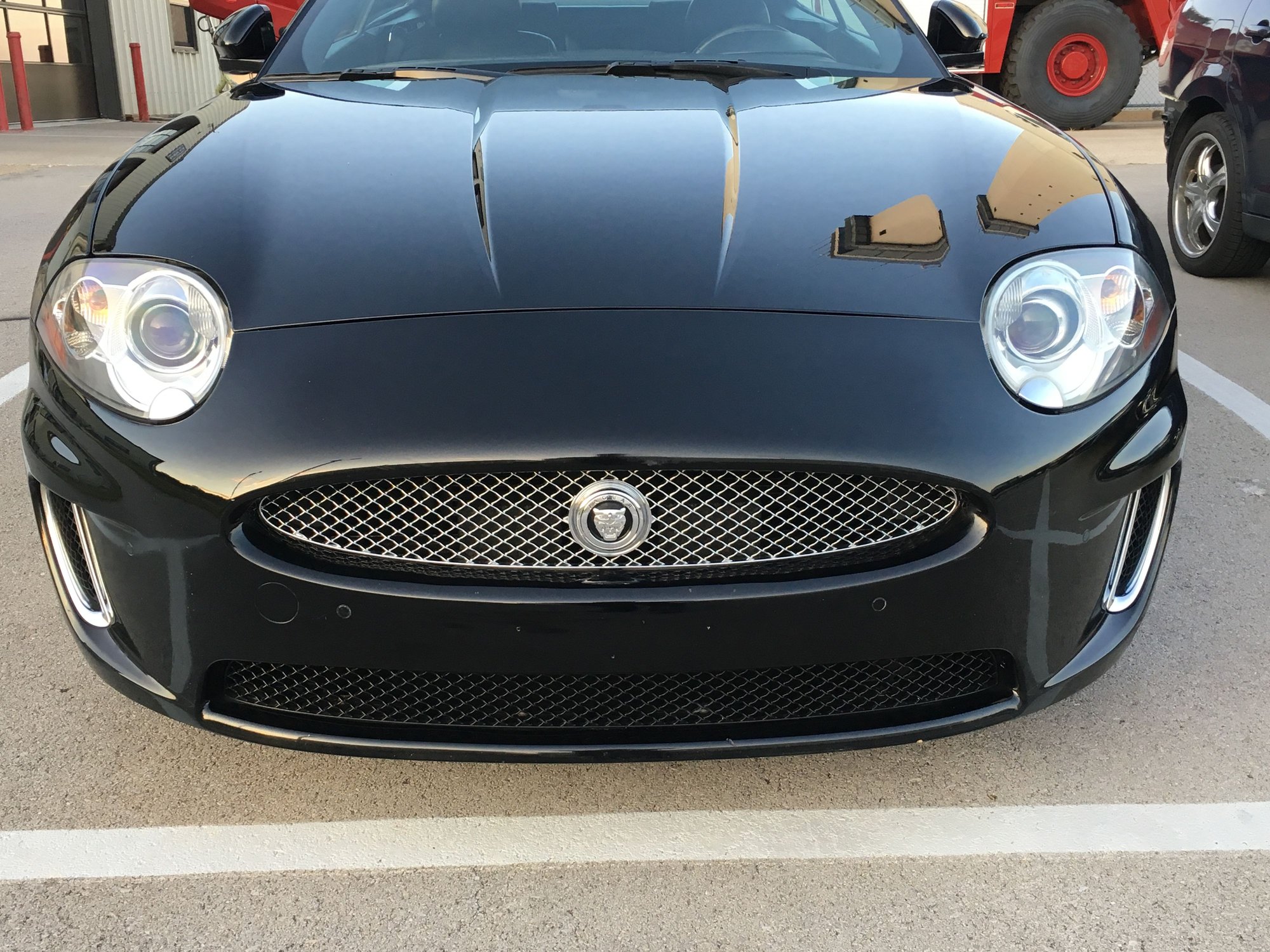

Old Sep 11, 2017 | 11:16 PM
  #85
Matt Harrell's Avatar
Joined: Sep 2017
Posts: 74
Likes: 7
From: nashville
As you can see from the pic the passenger side is straight on but the drivers side is cross eyed.
I've adjusted all I can with the set screws and it's still way off. That has me thinking these are adaptive headlights and the drivers side is broken.
I'm just not sure on the fix, besides buying a new assembly. Thanks for the help!!
Old Sep 12, 2017 | 03:17 AM
  #86
Ranchero50's Avatar
Joined: Mar 2017
Posts: 2,936
Likes: 978
From: Hagerstown MD
Start here where I sorted mine out. I forgot about swapping the AFS module on the back of the lamp housing as well as swapping the lamps side to side to see if what the problem follows. basically do as much as you can to isolate where the problem is without ordering parts. You just need to think about troubleshooting logically.

Old Sep 12, 2017 | 10:59 AM
  #87
JackJohn's Avatar
Joined: Sep 2008
Posts: 727
Likes: 202
From: Richmond, TX.
Matt, I never tested the active headlamps until after I fixed the broken one, so I don't know the answer to your question. As can be seen from your picture, the car has a broken headlamp assembly. Before thinking about $1K assemblies, pull it off the car and take a look inside. As Ranchero said, there is only three bolts holding it in. The first two are on top and the third one is in the wheel well. Turn the wheels as far to the right as they will go, then look into the front of the wheel well. The third bolt is easy to see. With all three out, lift and twist the assembly (I don't remember which way) out of its bay. Unplug the wire connector and the washer hose then the assembly will come away from the car.
