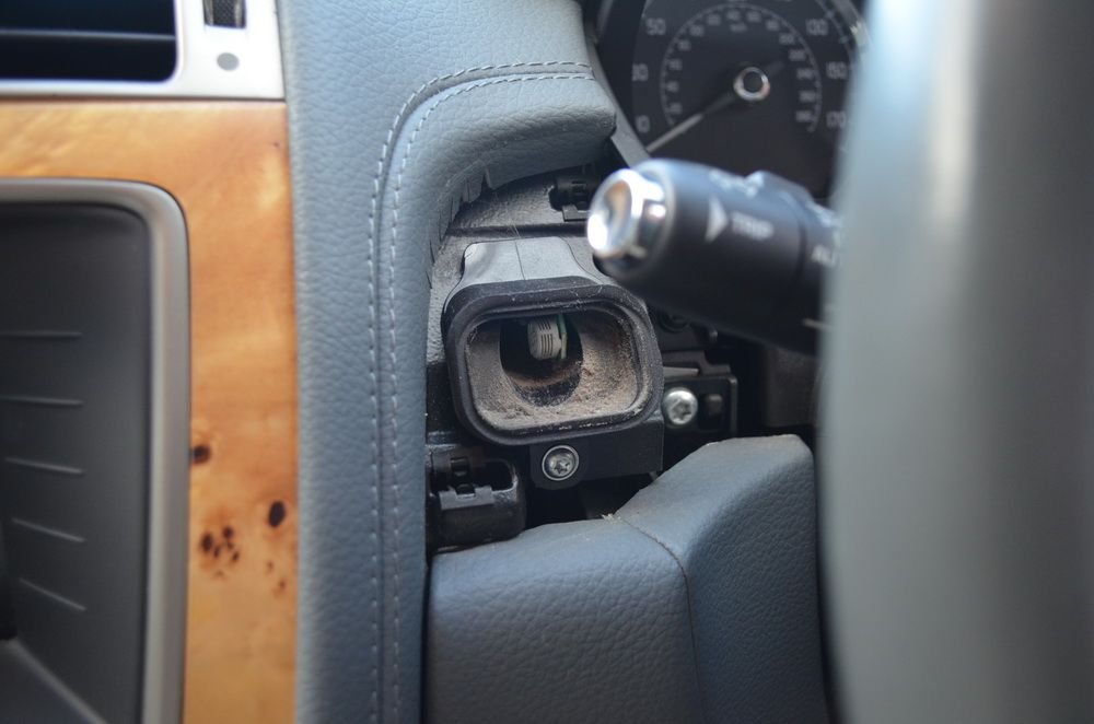

The sound made by the aspirator usually isn't noticeable unless it's dirty.
Worth reading:
Noisy Aspirator

Like this typical example perhaps.
The XK is usually a lot quieter than the aspirator on the earlier XK8 but it was the size of a small cooling fan.
