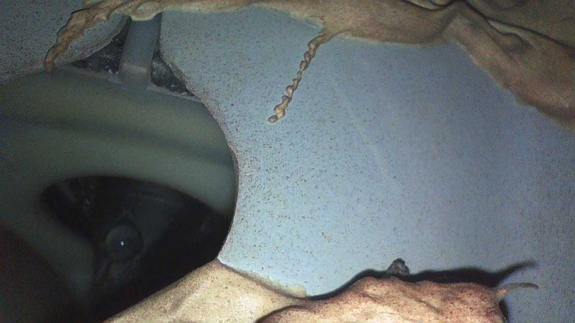

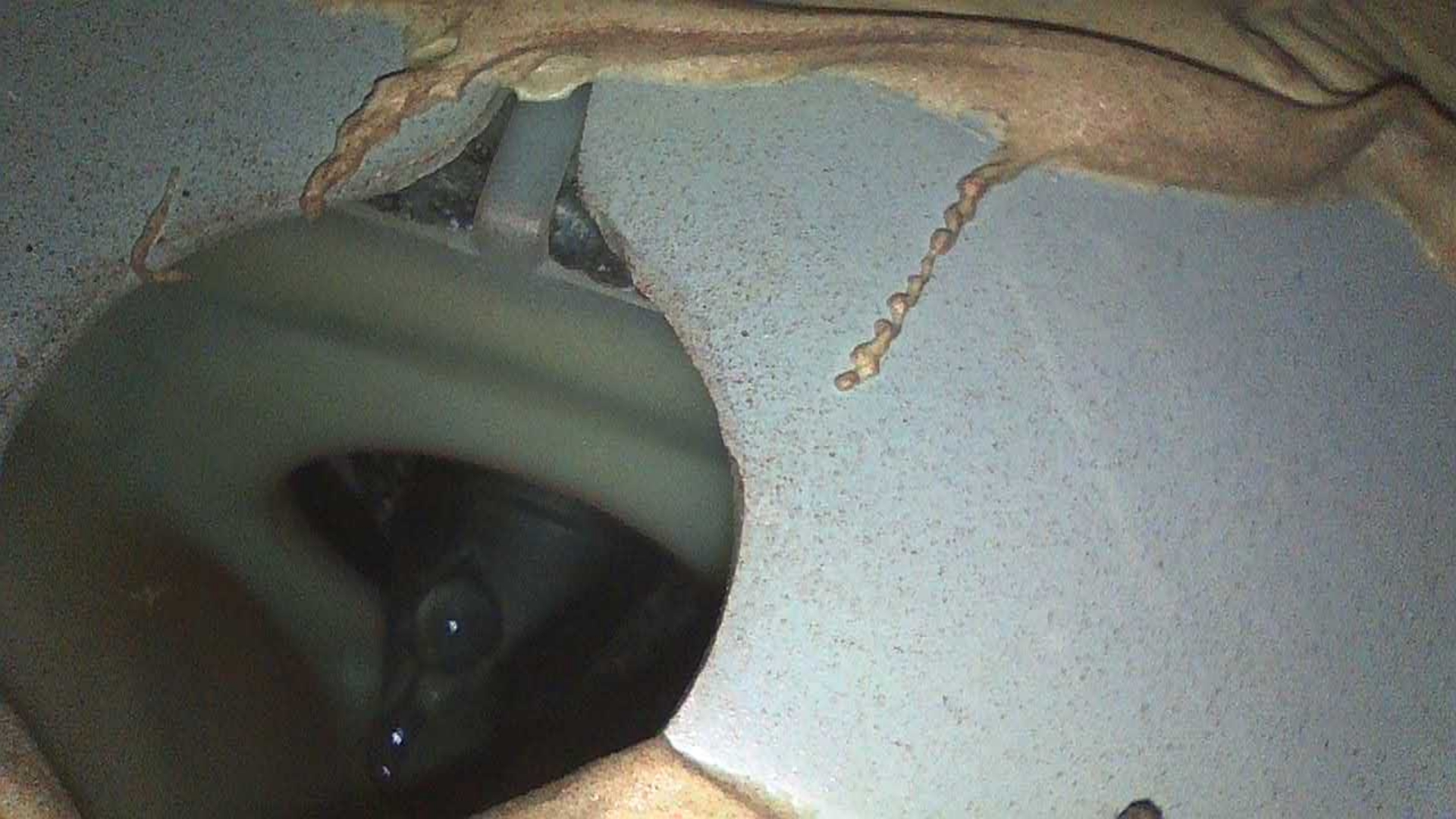

Old Sep 4, 2024 | 04:42 PM
  #354
Martin B's Avatar
Joined: May 2020
Posts: 17
Likes: 13
From: Arizona
Default Duckbill Photos
Attached are photos of my duckbill.
I'm curious what the 'eye' parts on the duckbill might be. I cannot get my hand near the duckbill to feel. Tight fit with the supercharger (XKR).
Thanks,
Martin
Thanks,
Martin
By the "eye parts" are you referring to the drops of condensate water which are about to drip off the bottom of the duckbill? If so, this is the point of the duckbill. It gives the condensate a short pipe to run along and then pass through the semi-closed duckbill lips before dripping off down through the hole in the metal plate and then running over the bellhousing and onto the ground.
Richard
