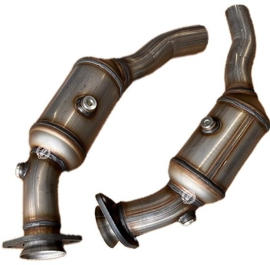

Same thing happened to me on my 2014 XJR. Injector failure flooded the engine and cats. Got that fixed and then had Cat efficiency code on one side of the engine. Fought it for several months with Cataclean and various O2 spacers and/or mini cats. No change and finally I had to replace that side catalytic converter. As you know cats are real expensive from Jaguar.
Do follow luv2fly thread links as there is an amazing cheap catalytic converter vendor on EBay with what looks to be a very high quality part for a very low price. So GIANT red flag right there!
Still take a look and it might not work since your in the UK but for $140 for a PAIR of cats it just too cheap to NOT look into!
Here are all the Jaguar cats he offers.
Jaguar Catalytic Converters
But the fabrication and weld quality at least in the pictures are top notch!
Now the question is are they any good? How long will they last?
Has anybody installed them?
They claim to met the EPA standards too. No mention of the cell count and I have found the best OEM ones are usually 400 cell count. The sport cats are usually 200 cell count and may or may not pass emissions.
Davico also makes after market cats and those are about $500 per side and on Rock Auto.
Hey they carry one for you 2006 XK and it's under $300!
2006 XK Cat Converter
Since your in the UK I don't know if these suppliers will work for you or not?
