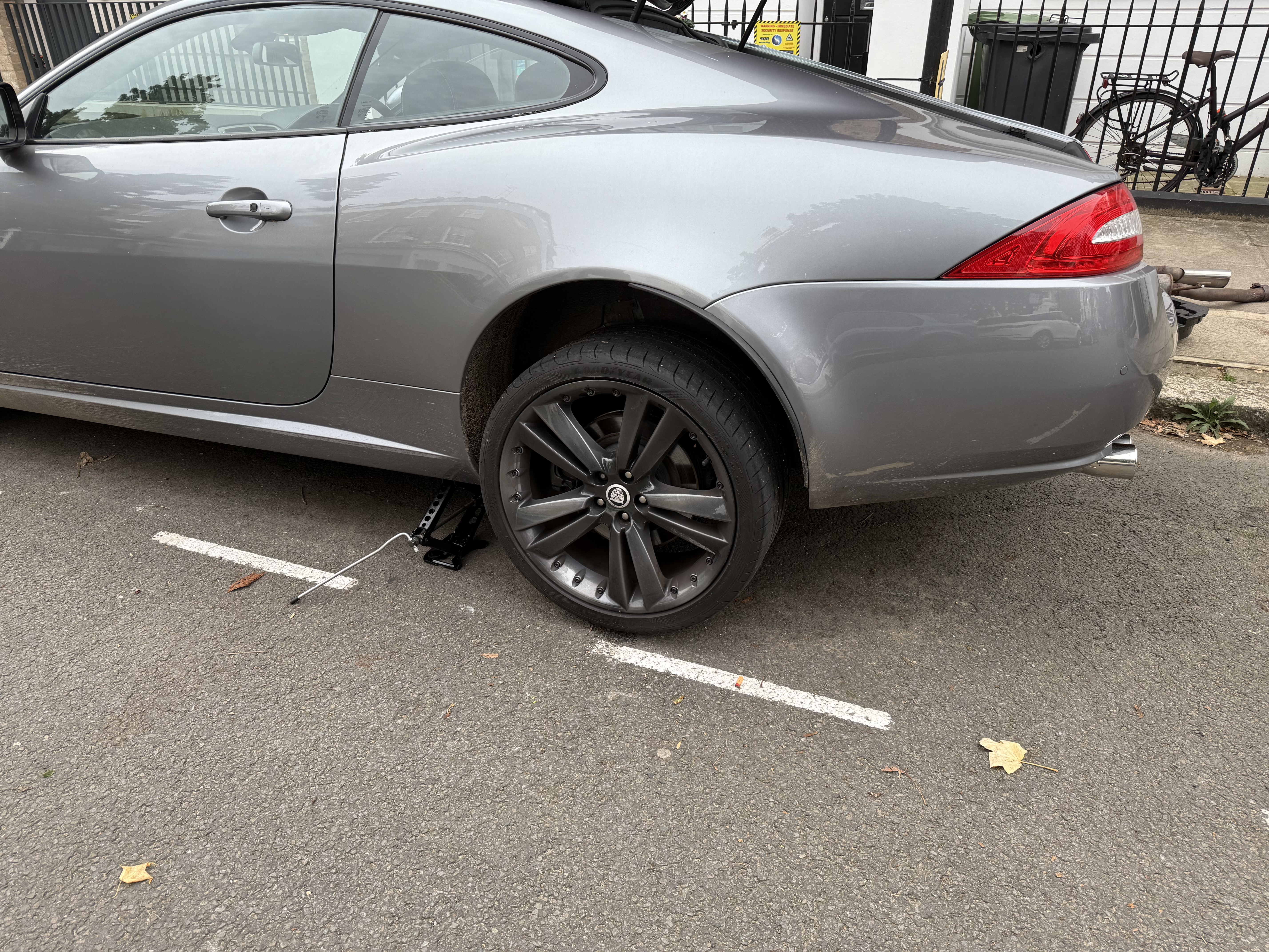

Well I finally found what wheel it is - jacked it up this morning, put it in neutral and… squeak squeak.
New pads are on, no contact between shield and rotor, and the squeak is coming from the centre rather than the calliper.
Time for a new pair of bearings
