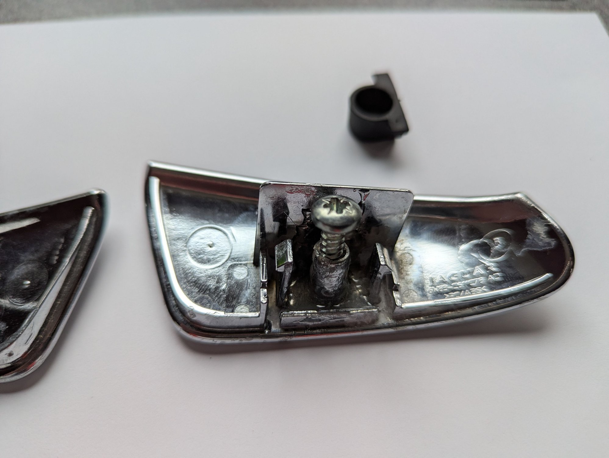

Old Nov 28, 2025 | 07:27 AM
J5hort's Avatar
Joined: Oct 2016
Posts: 262
Likes: 107
From: Massachusetts
Just wanted to post as I made the DIY fix for both levers that broke off. Removal was easy by pulling up lever base and removing Phillips screw. I found holding broken stub with needle nose pliers helped when removing screw.
I used JB Weld clear 5 minute epoxy and made sure not to get too much in hole so screw would not bottom out. Found that installing screw in stub just a bit helped to maneuver and hold stup in place while epoxy set up. Also reapplied more epoxy on the outside of the base of the stub to create more surface area adhesion and added strength.

I've just made a repair on mine similarly except the the female part was totally cracked and useless.
I used a a piece of 5MM ABS rod cut to length, drilled and treaded the screw in.
The first attempt to just glue it in with the same JBL product didn't hold to good.
I than made another except this time i used a thread die to cut threads (male) on the male end at the base.
After the initial bond I did a second coat from the base and up along the threads, which locked it in pretty good.
Also used a plastic welder with an external 90 staple on two sides to give it a little more strength.
That was a little tricky since the heated staple only takes a couple of seconds to melt in to the pieces and not to melt into the lever side too much.
Sort of just heat the staple till it glows red and release the trigger as soon as you make contact with the stud and the flat side underside of the lever.
So far good about 2 months and it typical is used every time we get out.
