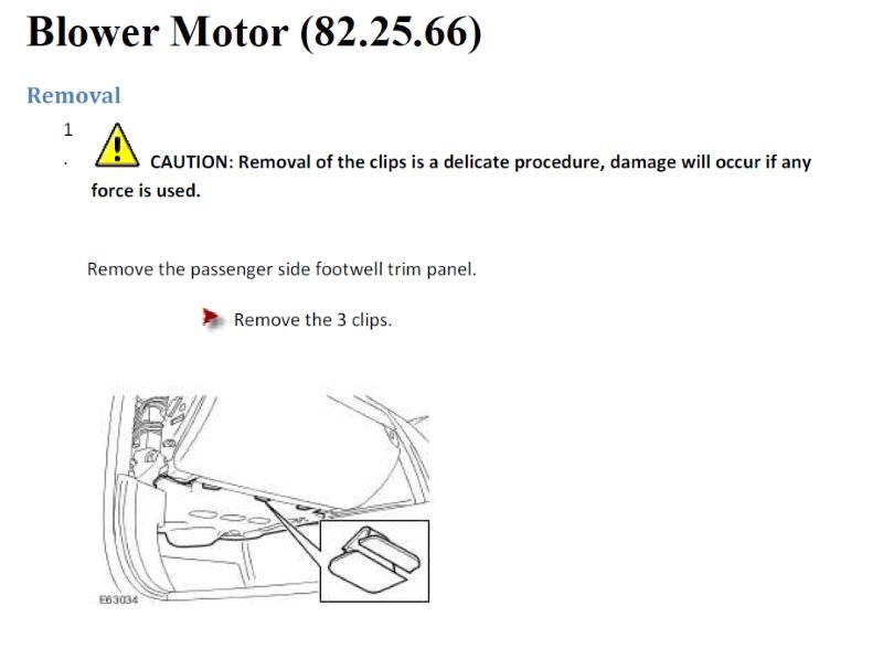

Easy to dismantle (and remove) - mine was squeaking from what looked like carbon dust from the brushes, cleaned it out, oiled the bearing as best as I could - been fine for at least 6 years. Be careful removing the cover as the funny clips are easy to destroy:
