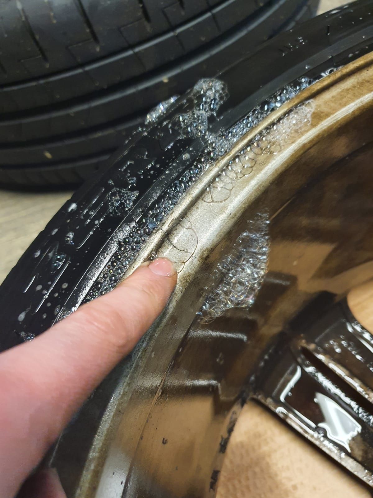

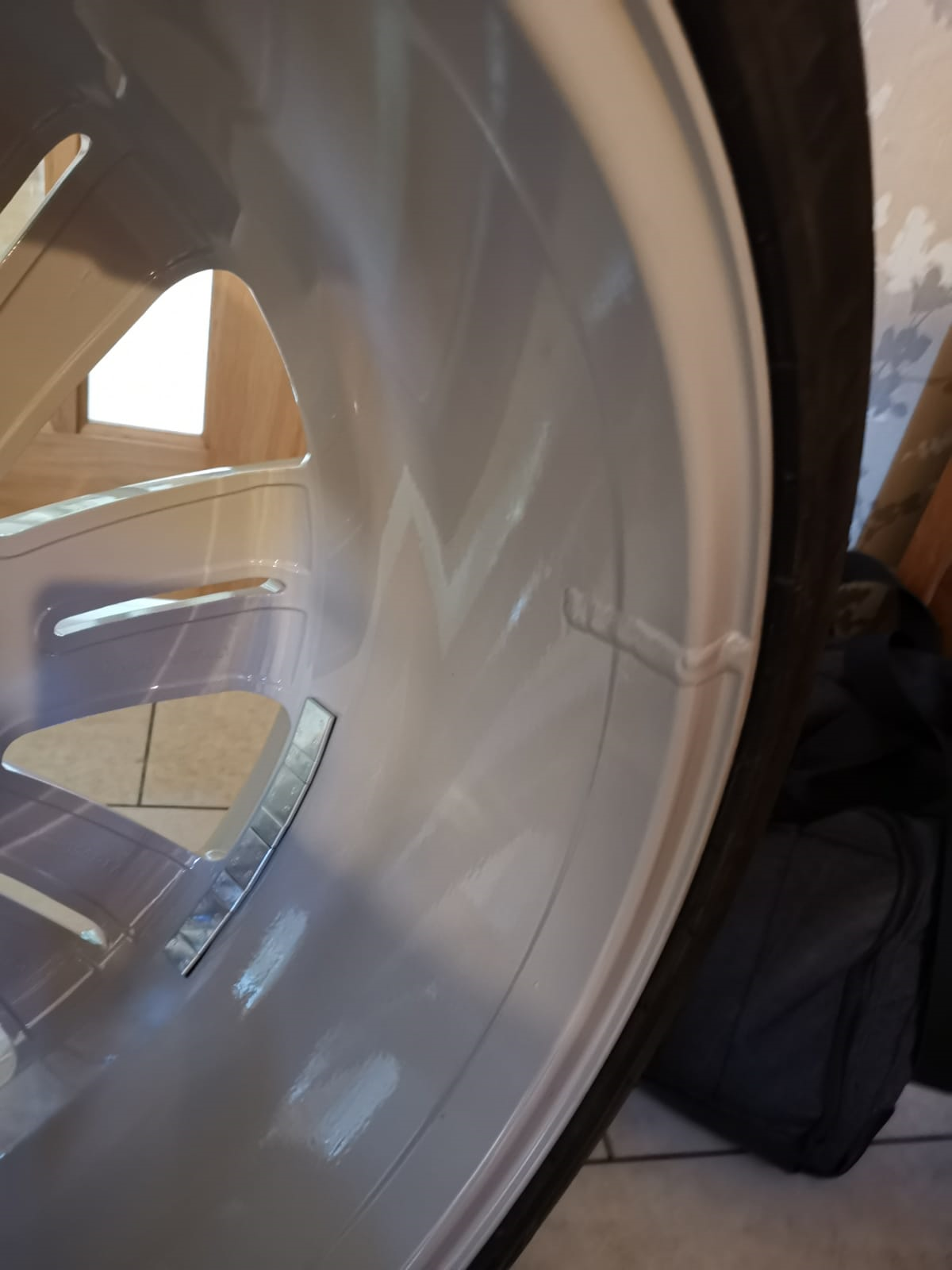

Well been plain sailing for a few months since swapping the battery for a new one, until one morning I notice tyre is a bit down on passenger side front, check with gauge and its at 19psi (nearly half what it should be!), other front is slightly down at 30psi, rears ok. Pumped it up, pressure didnt drop overnight. Drove 200 miles the day after, all good. Then come the morning tyre is down again. So I get it in to my garage for what I assume is a puncture, and the tyre tech tells me ive got a crack and a flat spot in my alloy.
Getting it welded and refurbed for now (Im aware people are split on this) as there arent any 2nd hand nevis fronts available at the moment. I must admit, people saying these alloys are like butter doesn't fill me with confidence this will be the first and last alloy I crack with this car. So to solutions:
Drop to 19" oem alloys, more sidewall (I like the tamaras)
Swap to aftermarket 20" alloys (better quality?) there are some tasteful BBS ones around for less than new oem
increase tyre profile all round by 5mm, cheaper than buying 19s and new tyres, but will it cause issues besides slight speedo inaccuracy? 5mm isnt alot, but adding it to a 30mm or 35mm profile tyre is a 15%+ increase is sidewall, so must make some difference?
Id like your thoughts, and your stories if this is a prolific issue for other XKR owners riding on the oem 20's.
