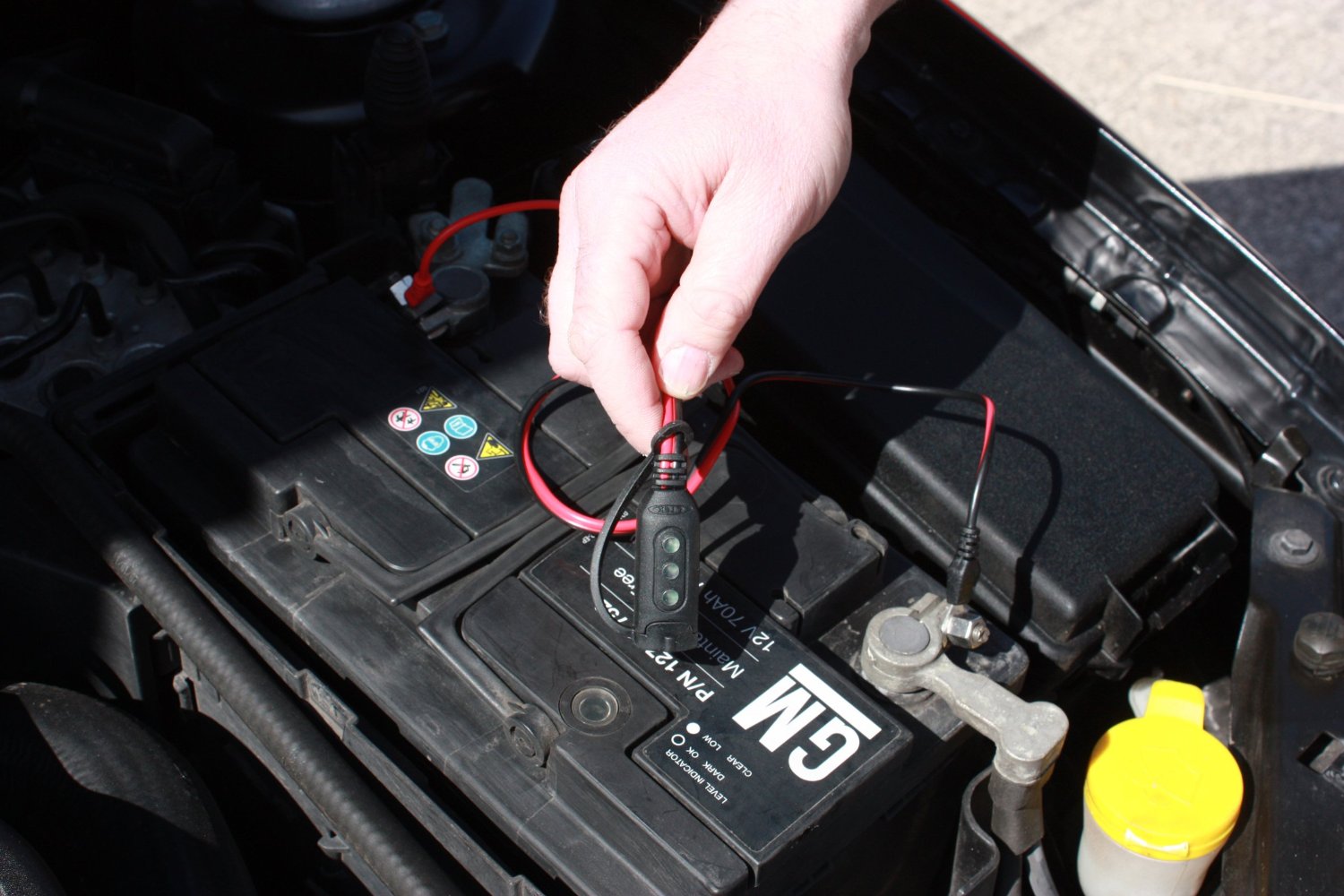

CTEK 3300 charger is in. Had difficulty with lock nuts getting stuck and not coming off or licking down. Used the clamps like a champ though....took 24 hrs to charge the black XKR.... Now to the red XKRS!!

Ryan:
Great to hear....The key to the lock nuts is proper size. Suggest you secure proper sized lock nuts and permanently attach the eyelet harness to the battery terminals.
You may want to consider another eyelet harness only (about $8.00) and then permanently attach one eyelet harness to the XKR and one to the XKR-S....then simply plug in the CTEK to each harness when you want. Plug and Play. If you feel you can use/need a longer CTEK cord, consider the CTEK comfort extension which provides another 8" of cord.
CTEK Comfort Indicator Extension : Amazon.com : Automotive CTEK Comfort Indicator Extension : Amazon.com : Automotive
Ideal situation is one CTEK 3300 for each car.
Good job, and hope you like having the CTEK 3300. It will provide a lot of confidence and peace of mind regarding battery power.
If you leave the CTEK attached you will actually see the light go from Amber to Green and back and forth. Green of course is what you want.
CTEK 56-261 Comfort Connect 3/8" Eyelet : Amazon.com : Automotive CTEK 56-261 Comfort Connect 3/8" Eyelet : Amazon.com : Automotive
Amazon.com: CTEK 93-56-382 Black Comfort Indicator Eyelet: Automotive Amazon.com: CTEK 93-56-382 Black Comfort Indicator Eyelet: Automotive
Attached Thumbnails CTEK 3300 Battery Charger Installation-ctek-eyelet-battery-terminal_.jpg
