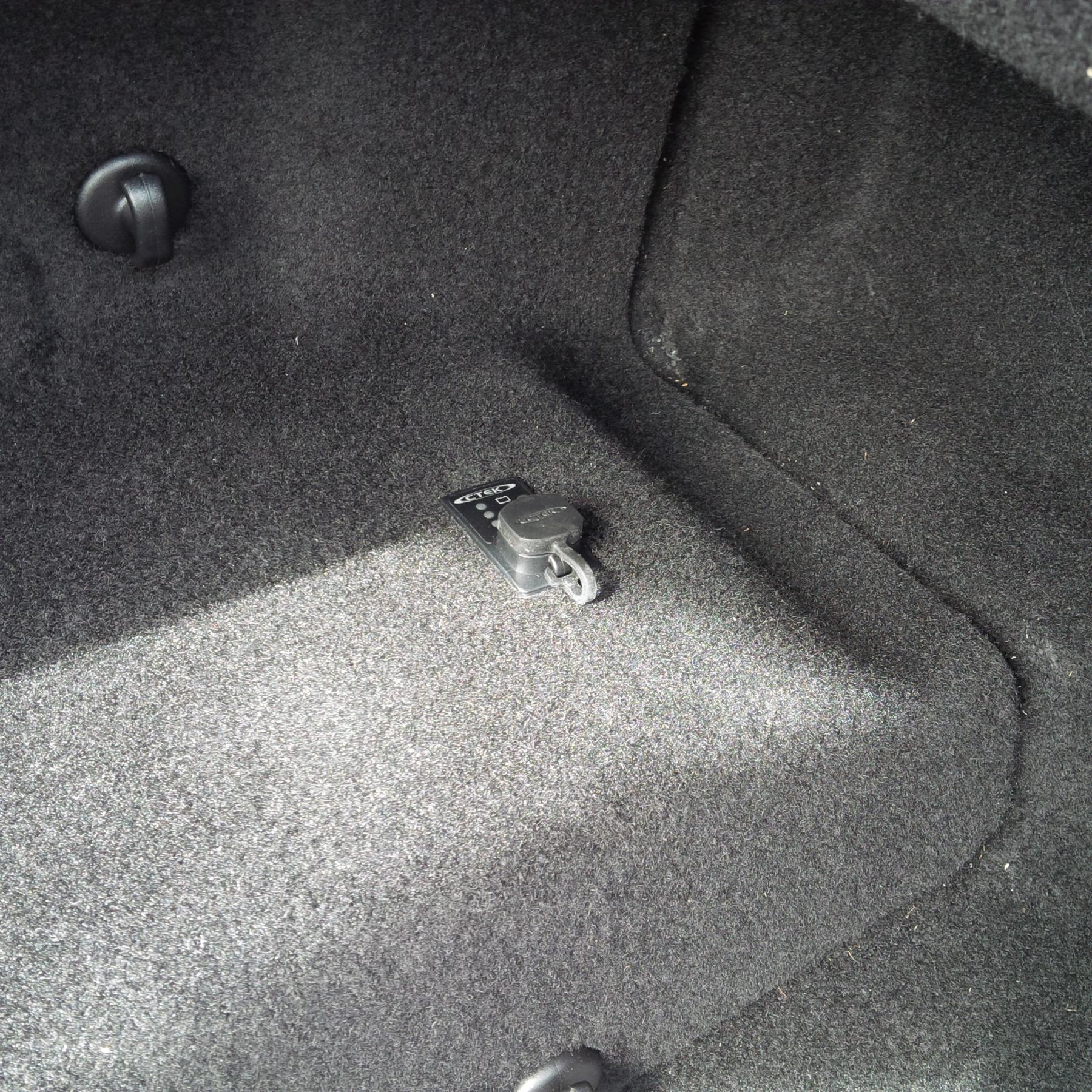

I installed the convenience connector in my trunk this after. The location makes it real easy reach and it doesn't obstruct the luggage area. A very easy install... took all of 5 mins.

Very nice, clean install. Did you have to cut the carpet?
Yes, I cut from behind using an x acto knife. The material in very easy to cut through and the CTEK connector comes with a template.
