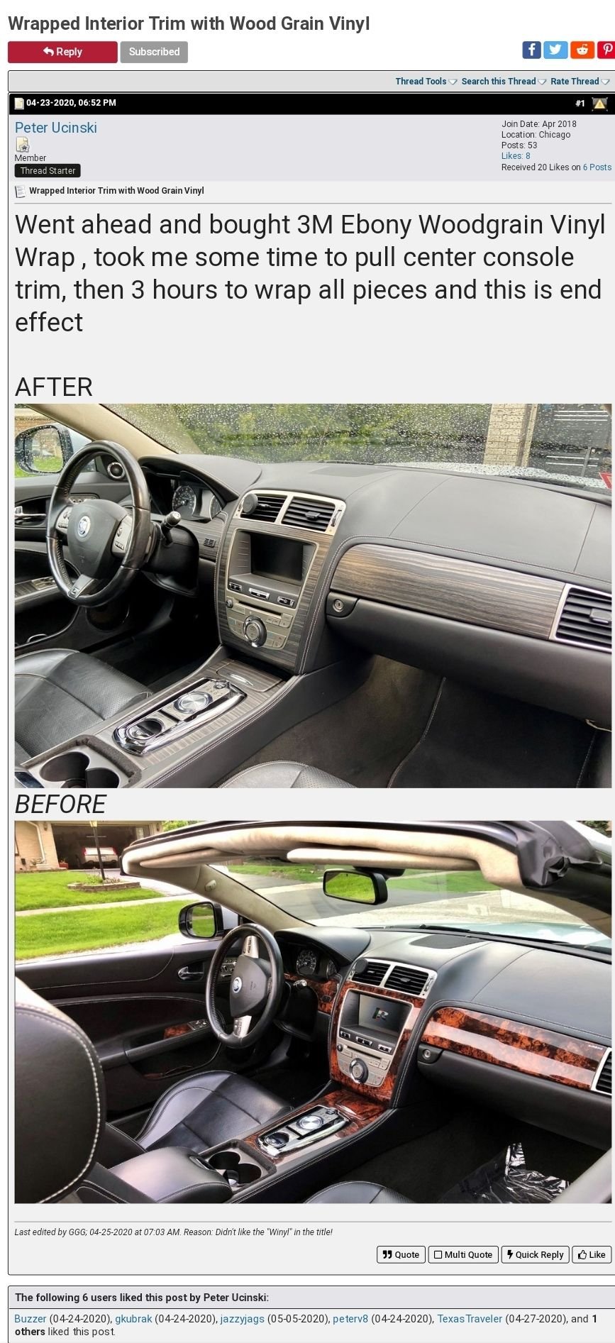

Place a "Parts Wanted" ad in the Forum Marketplace. Also check Ebay for "2007-up Jaguar XK wood dash trim."
You can also wrap your existing trim with vinyl that replicates genuine burl wood or other veneer. It's the best bang for the buck.
https://www.jaguarforums.com/forum/x...-vinyl-231720/

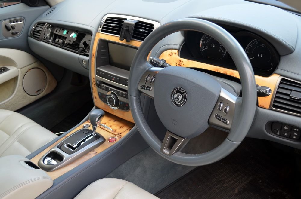

Old Apr 4, 2021 | 05:12 AM
Originally Posted by JDog
Are you sure? I have a 2013 and there is a air bag behind it. When you pry it up there are two straps that hold the dash plate from hitting you in the face. I don't know how to remove the wood dash plate without setting of the air bag.
This is my RHD and the earlier XK 4.2 model BUT the passenger trim / airbag is the same on the later 5.0. This is what's behind the veneer:
I looked on Jaguar TOPIx for the Veneer Kit fitting instructions but it's been removed.

Thanks very much for the removal instructions. It is funny they want you to throw away the old cover. I guess this was written before carbon fiber. Is there somewhere that I can buy the oem burl walnut dash covers? Stuart S does the stick on vinyl look cheesy after installation? But I am probably jumping ahead. I have not even got my car yet. I might just like the color in there. I will probably be driving it so much that I don't have time to change it out. Thanks for everyone's help.
... Stuart S does the stick on vinyl look cheesy after installation? But I am probably jumping ahead. I have not even got my car yet. ...
Quality vinyl wrap properly applied looks very realistic and is hard to distinguish from the real deal. Ask the Forum member who did it whose name is in the photo in my Post #9, above. Good luck in your quest to find the X150 of your dreams.
