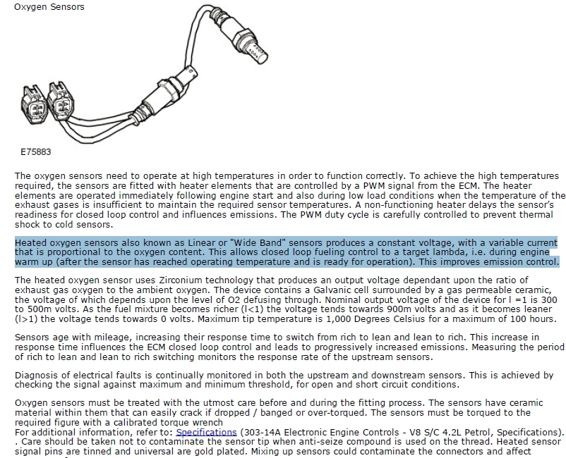

Says wideband in the workshop manual for the 4.2L XKR
Do our cars have wide-band o2 sensors? Using torque Pro app-screen-shot-02-09-17-10.44-pm.jpg
Attachment 142455
Is my car different?

Long story short, you can't at WOT, the PCM "switches off" the O2 sensors and just runs off the fuel mapping. Only option is a 3rd party wideband.
Can't imagine why it would be...
When you say "reading remains unchanged" are you looking at voltage or current? The upstream sensors have a fixed voltage output, variable current.
