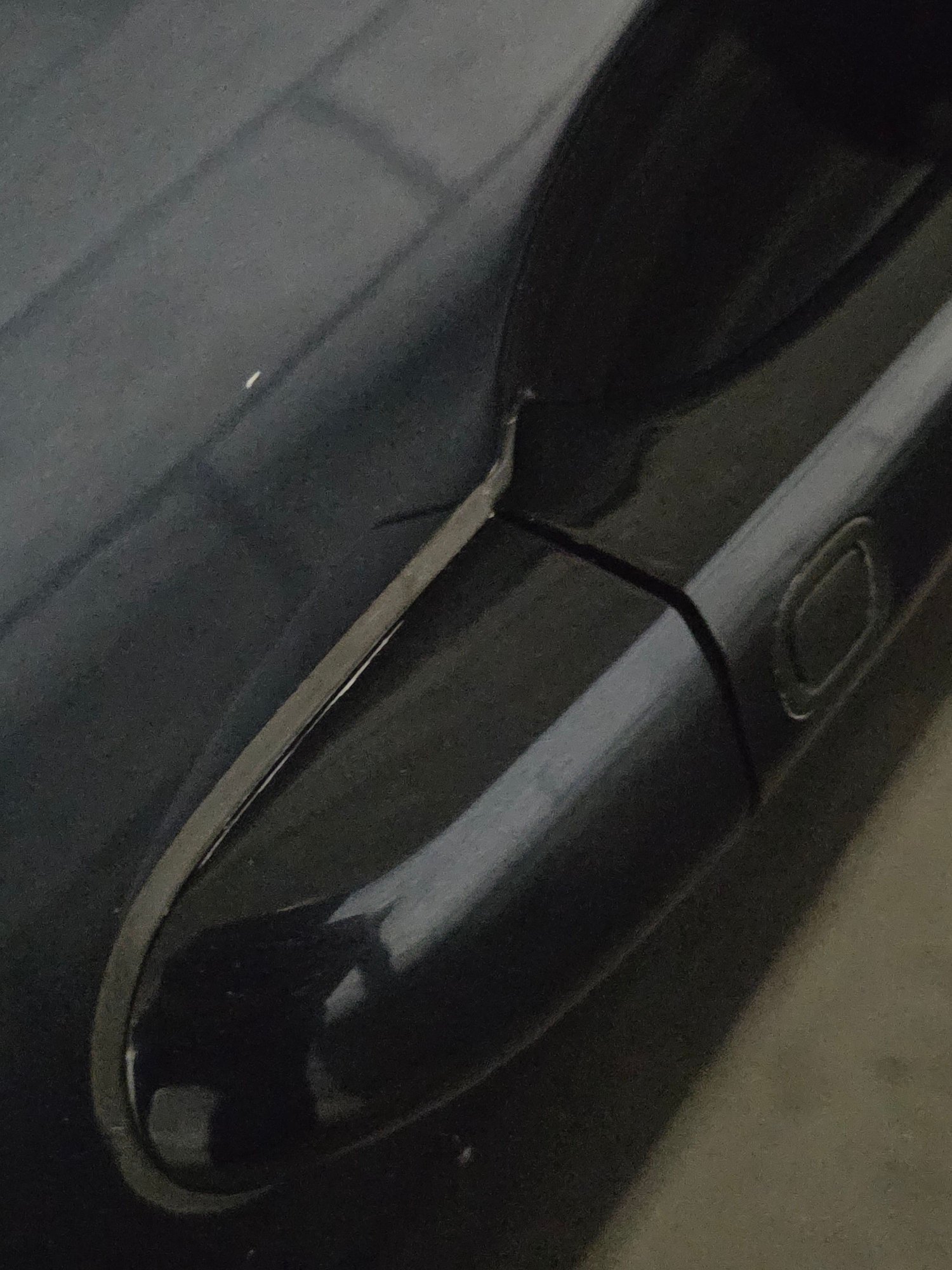

Default UGH
Here's what I got
Like a beautiful woman with a wart!

Originally Posted by HealeyJag
Here's what I got
Wait, your unlock button is silver??
My 08 button is paint match. Wild!
Old Nov 26, 2025 | 07:14 PM
Maybe an R THING...
Looks black to me. Mine's black also.

passenger side
passenger side
ahh so the black rubber over that unlock button just rubbed off.
