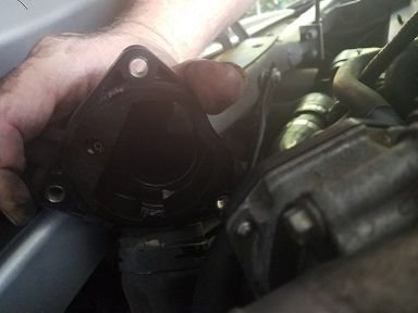

Here is what we have found!
So, the thermostat definitely broke, but also looks like the plastic in the pic below is broken, but we don't see any loose pieces anywhere.
The smaller housing piece that I ordered looks fine but we will replace since we will have it. The worst part is having to order parts from several different sources to get the all here in a timely manner.

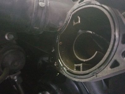

Yeah, not good. I would pull the water pump out and inspect the plastic vanes. The missing chunks end up down there and can cause havoc. Pretty simple to remove but messy since it's lower than the coolant drain ports.
For reference, here's the opening for the water pump once it's out of the way. Straight shot up to the T stat housing.

Agree, those "extra" parts can really cause problems in the coolant system!
