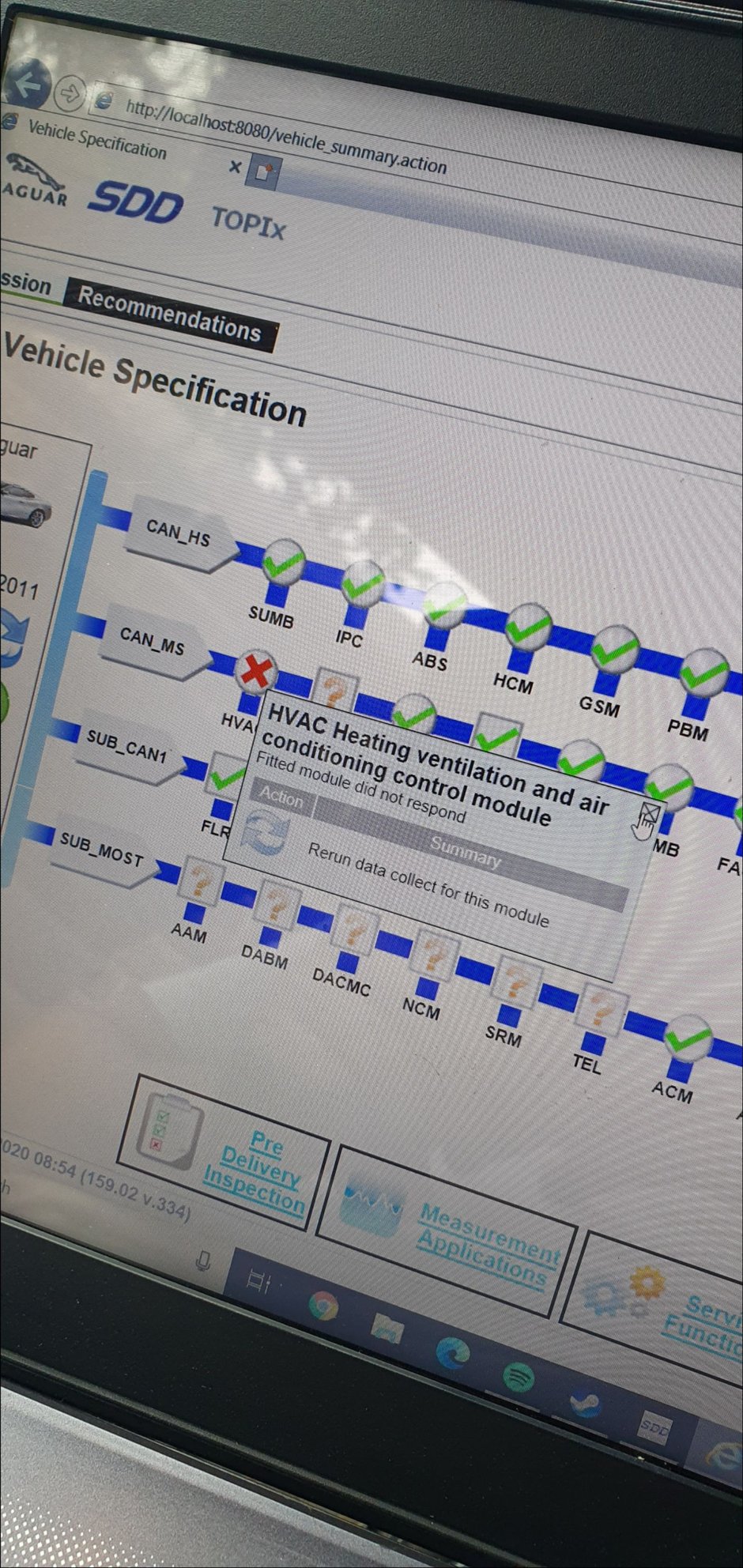

Following on from my temperature sensor issue, showing -40 on the screen, new tested sensor with no change. Connected SDD and found this, not sure how to use SDD and not sure what to do from here! Any help would be appreciated

Found the fault. I was unaware of the passenger footwell fuse box! F6 15 amp was blown, new fuse in and all working. 3 months without aircon in this heat for it to be only a fuse!
