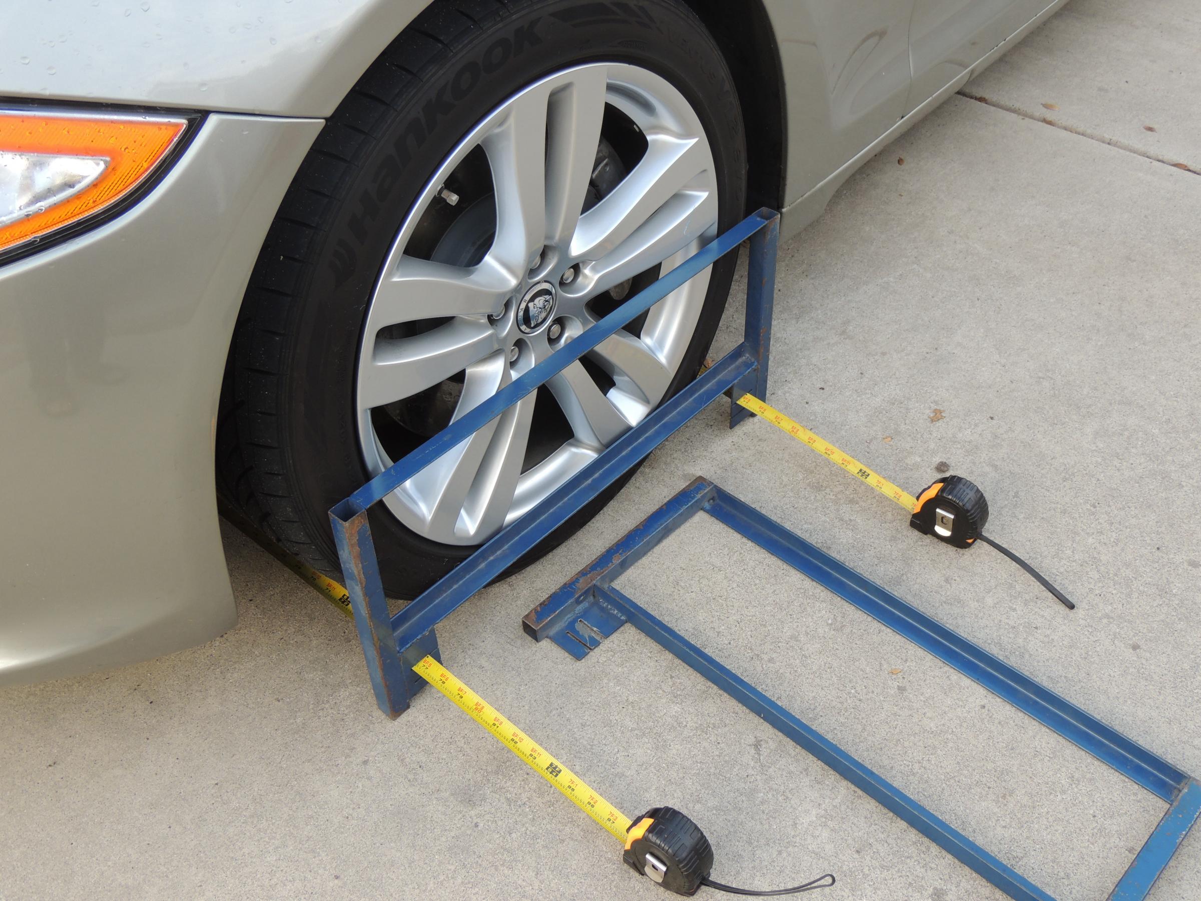

Plums - Like I said, simple home-made tools. I used to have a digital camber gauge when I was racing but gave it away with last race car when I sold it.
As seen on the picture, the Toe setup is something I welded up myself. It is a pair of brackets with two identical tape measure to check the front and rear distances between the tires.
My camber checker is even simpler; a 3' bubble level. I set it to vertical, measure the distance from the level to the top of the rim, to the bottom of the rim as well as the exact rim size and do a super quick trigonometry calculation to determine the angle. Those two produce very accurate numbers for me, as shown by comparing my measurements to actual laser setup measurements in shops.
Needless to say, the measurements must be taken on level grounds that you either have/make or shim with thin layers of plywood.
