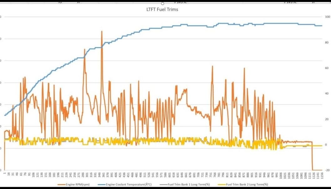

To update the fuel trims, I fitted C2P3419 and bodged a 3mm hose to replace AJ811093 as that part is back ordered - I have been looking at the fuel trims as its takes a number of cycles for the LTFT to even out and they are now close to 0 at idle, fluctuating around +/- 1 percent or so. So the Vacuum hose was the source of the lean fuel trim.
I will do a better bodge over the weekend with better quality silicon cut to the correct lenghts as the OE pipe, which I probably do not need anymore
