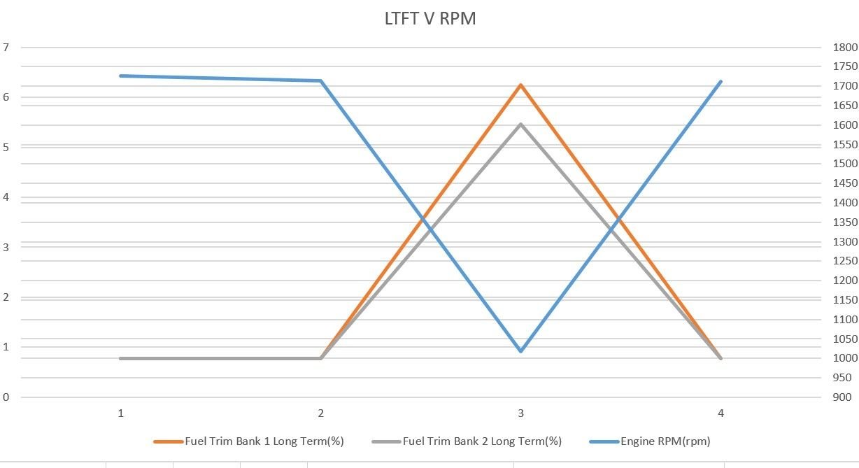

So I plugged in my OBD reader and used Torque to see what is going on and my long term fuel trims are around 7 percent positive, Bank 1 is higher than bank 2 slightly - not massive but it points to a vacuum leak somewhere around the MAF.. any ideas? The trims go back to 0 at around 17000rpm so that confirms its a leak - guess I will be having to take off the wheel arch liners, again..
The timing advance graph is here, this is from a brief spin to the shop - engine was warmed up
Update - looking into this I can see I fitted new air filters last october - expensive BMC - I also had a torque log from last summer - fuel trims were 1.5 percent long term...
I think we have our answer here?! I know the AJV8 is really ficky with air filters and here we can see it clearly --
** actually scratch that, I think this might be normal due to the cold weather-- not entirely convinced its the air filters as I looked at more logs after they were fitted and the long term trim at idle was around plus 3 which is fine, I will inventigate my piping...

I think this is a case of "much ado about nothing" - I have looked into this and fortunately have torque logs from when I got this car a year ago and looked at them - the fuel trims were always hovering around 6 or 7 percent positive at idle, which makes me think it is what it is - the car runs fine and has just passed the MOT - 50k miles, o2 sensors are responding well and its not the Catylic converters.
I have a MAF sensor <somewhere> from my Subaru 3.0 SpecB which is the same Denso as used in the Jag, what I will do before I decide to get new MAF sensors as they could improve the fuel trims, is put in this MAF and see how they react - its just that like anything on this car doing jobs is a bit of a pig.!

The MAF sensors are crucial for trims and when I studied previous data I can see both banks reacting the same, an easy check is to swap out the MAF and see what happens, if it fixes it I can get new MAFs but not before I get some confirmation.
You aren't going to get zero trims on Jaguar XKs that are over a decade old, plus or minus 2/3 percent would be pretty good - fortunately I have another Denso MAF somewhere to try out, I can fit that and run for a few days and see what happens
