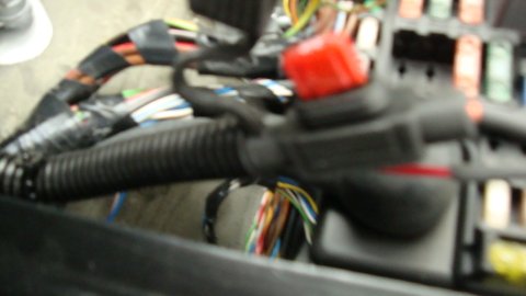

with a line fuse and switch. I removed the fuse and replaced it with a blown fuse then I soldered a wire to each side of the fuse and run one one wire to a line fuse and then on to a switch placed in the side of the center consul then from the switch back to the other side of the blown fuse which is then incerted in the fuse box, this way it is protected when the exhaust is turned back on to normal. Buy the way I love the Rap when the exhaust is turned off.but it could be louder. BL.

Nice job and pics! Must of been scary, just before drilling through the leather huh? I also like the lighted switch.
