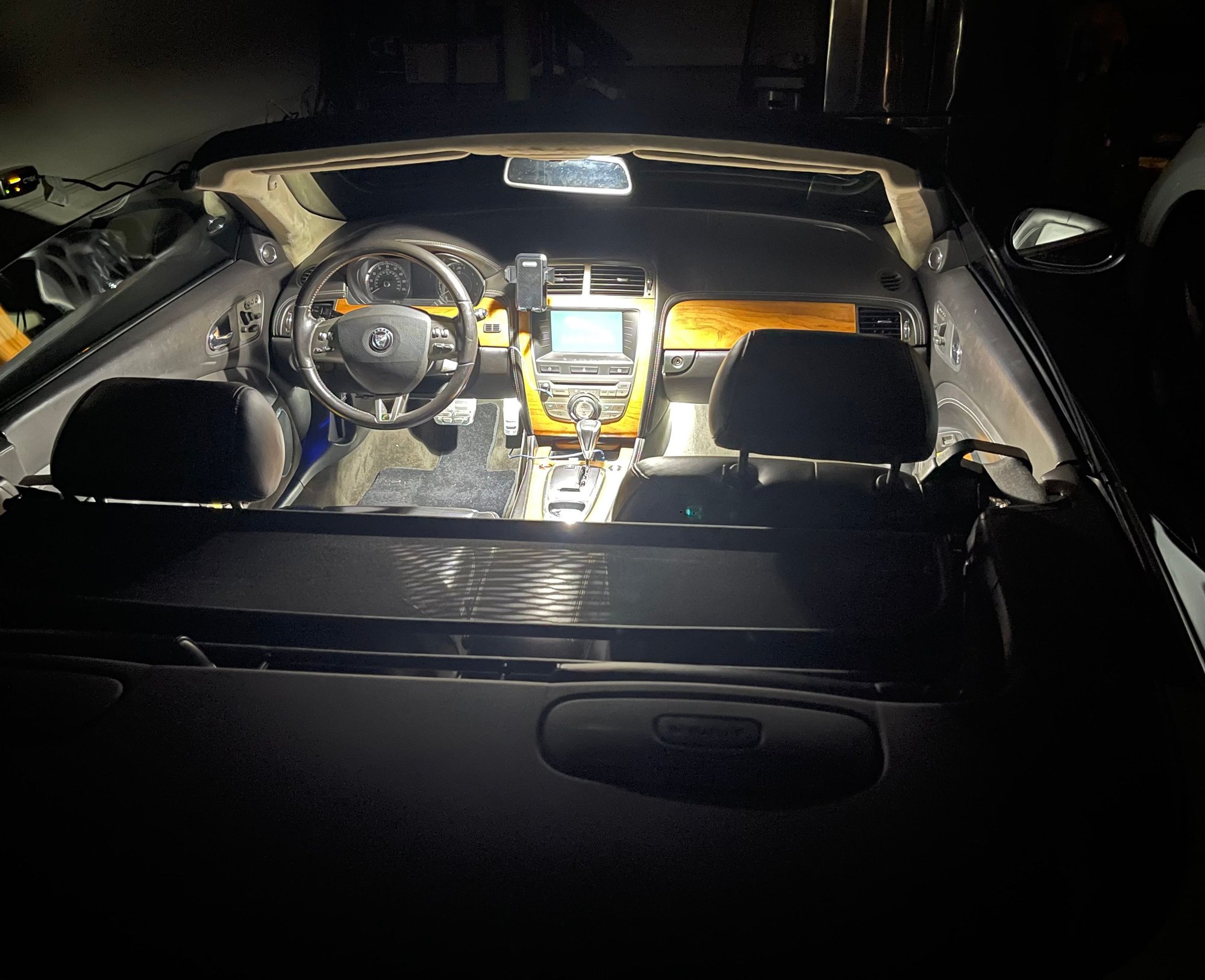

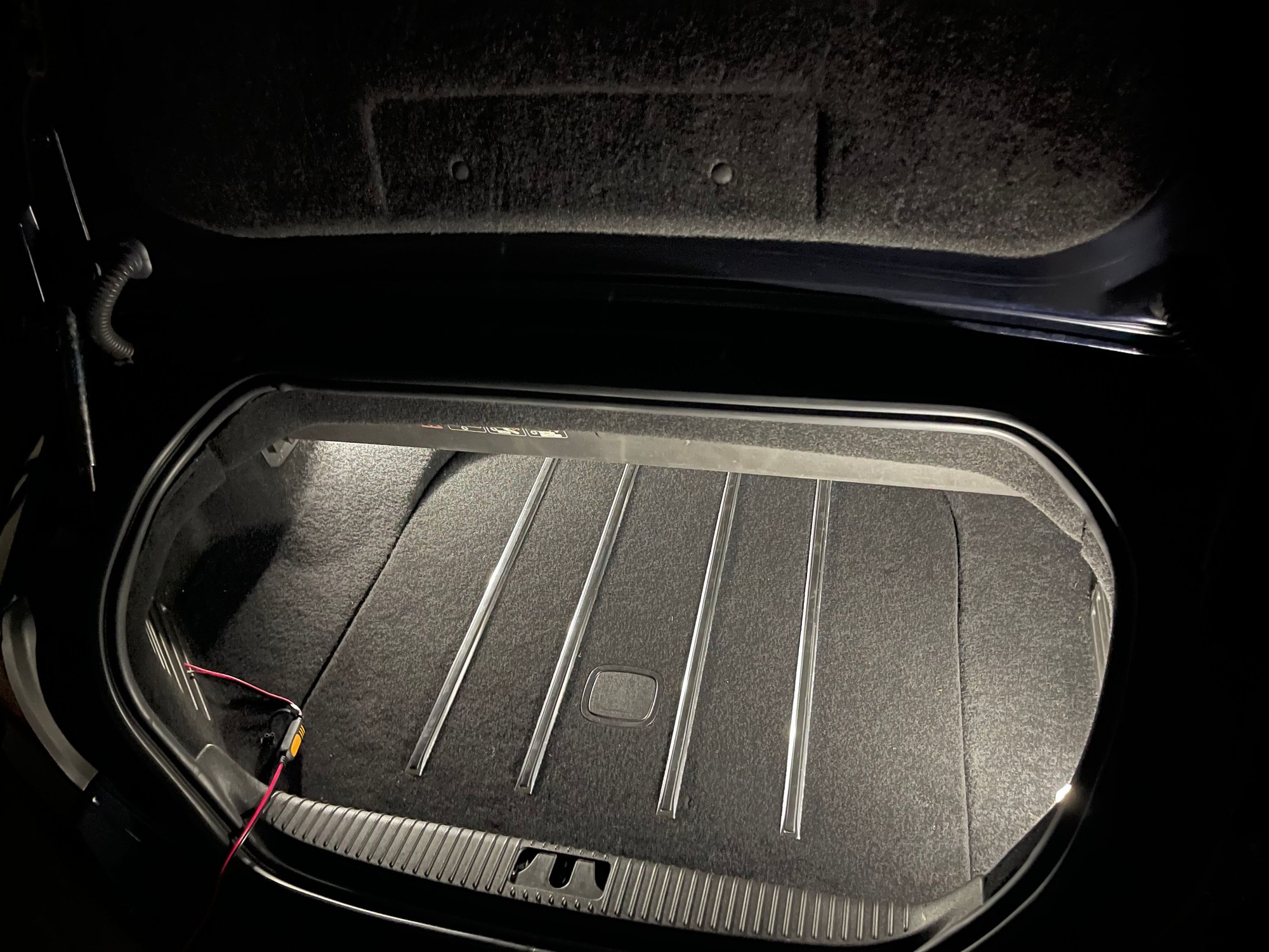

Ask and you shall receive.

Quite vibrant now, huh? That'll help you out a bit when you do the interior detail that is overdue. Mine needs one also.
One of my favorite upgrades so far.

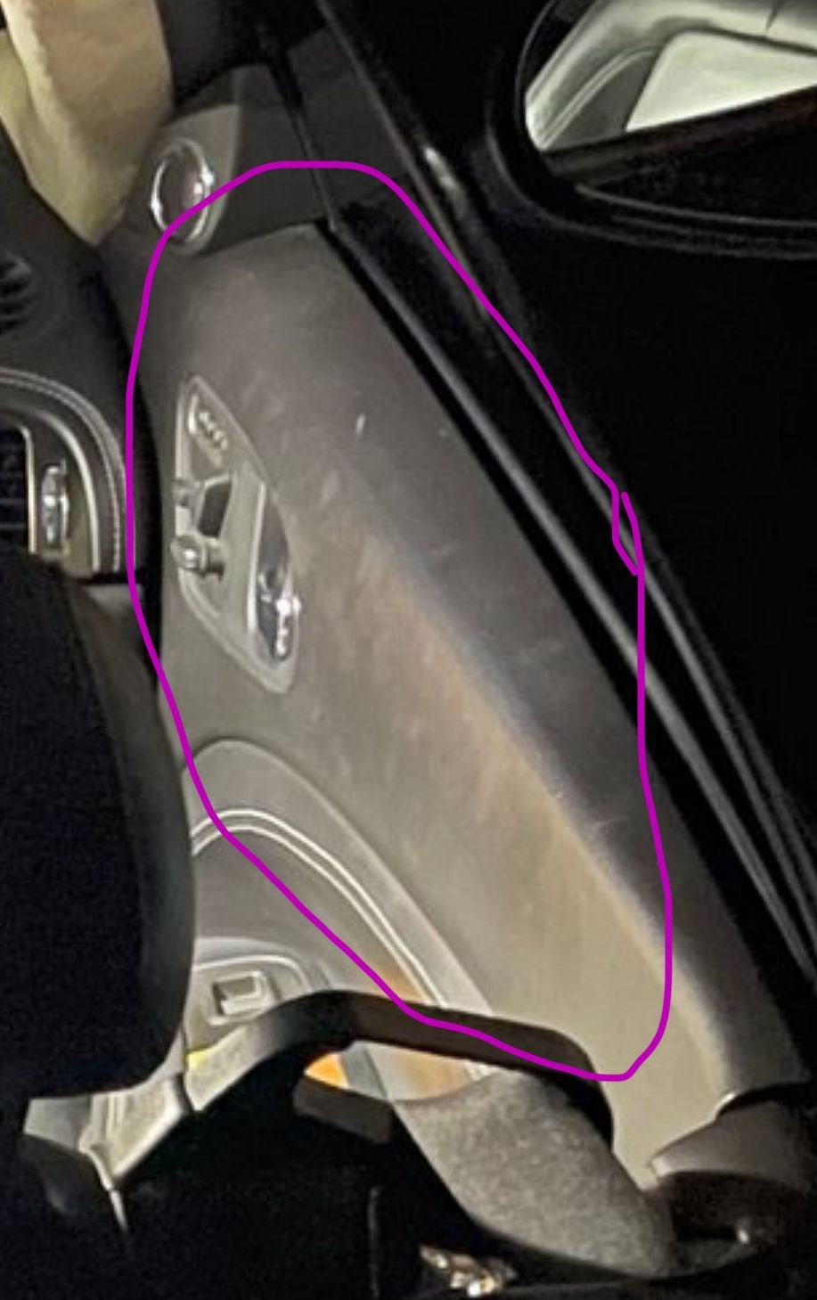

About that interior detail. Brilliant of you to notice. I’ve been saving this one as a new post. And will save it a bit longer, but I have a ton of questions about what can and cannot be fixed in there.
Staying focussed on 2-3 things at a time though.
But yeah, lots of knicks and rubs.
These on both sides bother me the most:
