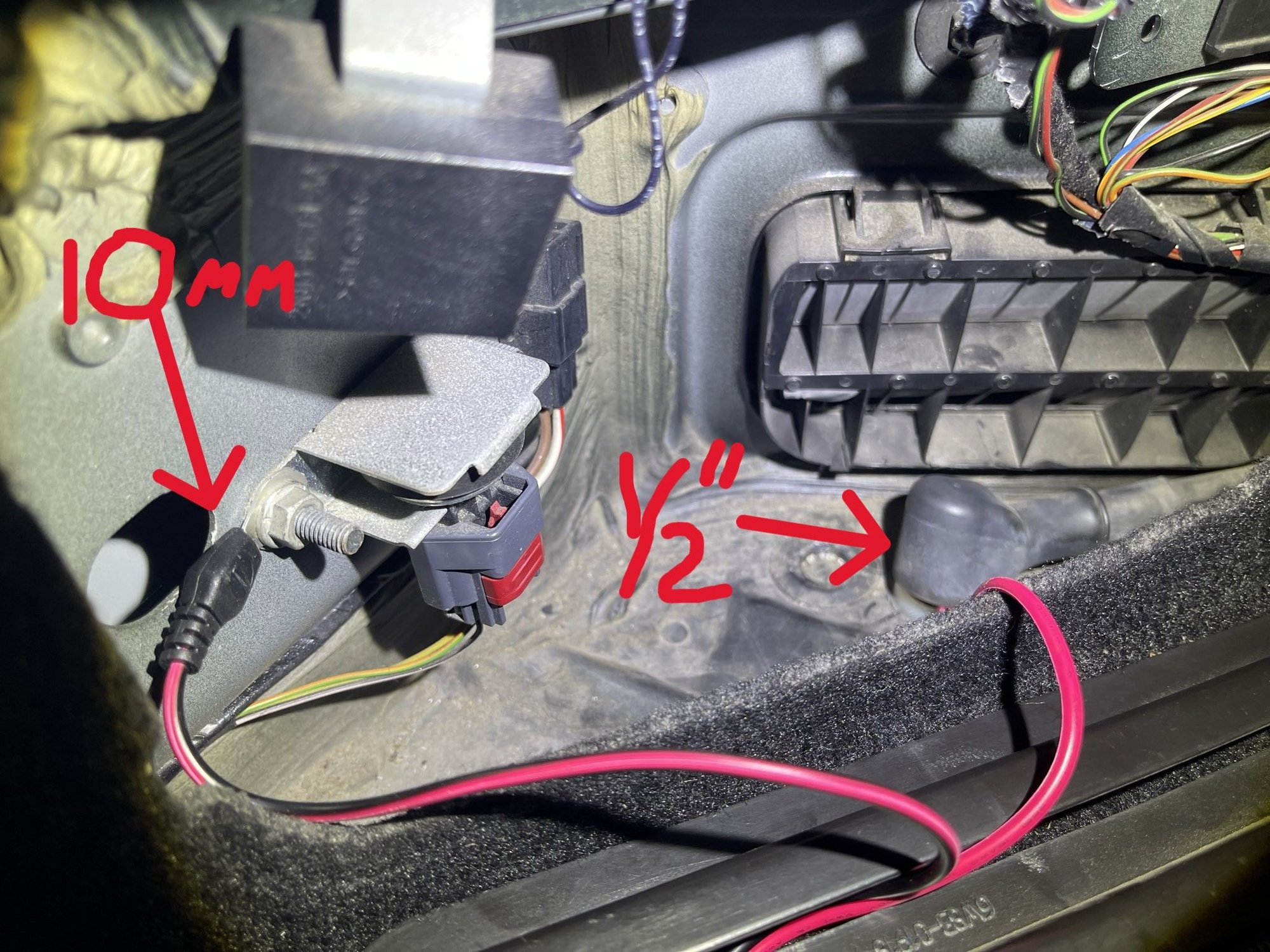

Ok, so my Ctek arrived today as well as the addons I purchased.
Watched the LifeOnCars video where he hardwired his, but did a modified version in the boot instead of directly on the battery.
Read some comments that direct to the battery bypasses a sensor or something.
Couple of notes:
The Ctek MXS 5.0 comes with alligator clips and 7/16" eyelets.
The connectors in the boot/trunk are 3/8". A 7/16" is a hair too large and won't make great contact.
I added the 8 foot "comfort clip" extension, so I could mount it on the wall and whether I pull in or back in, it will reach.
The LifeOnCars dude said he had to trigger the boot latch to turn off the lights.
With my convertible, the lights go off after a couple minutes, so no concerns leaving the boot ajar.
Also, with the 3/8" eyelet kit, the pos and neg leads are split. This was perfect and I was able to feed it through the plastic cover vent.
(Photo below)
All in was around $125 plus tax.
10mm ground, 1/2

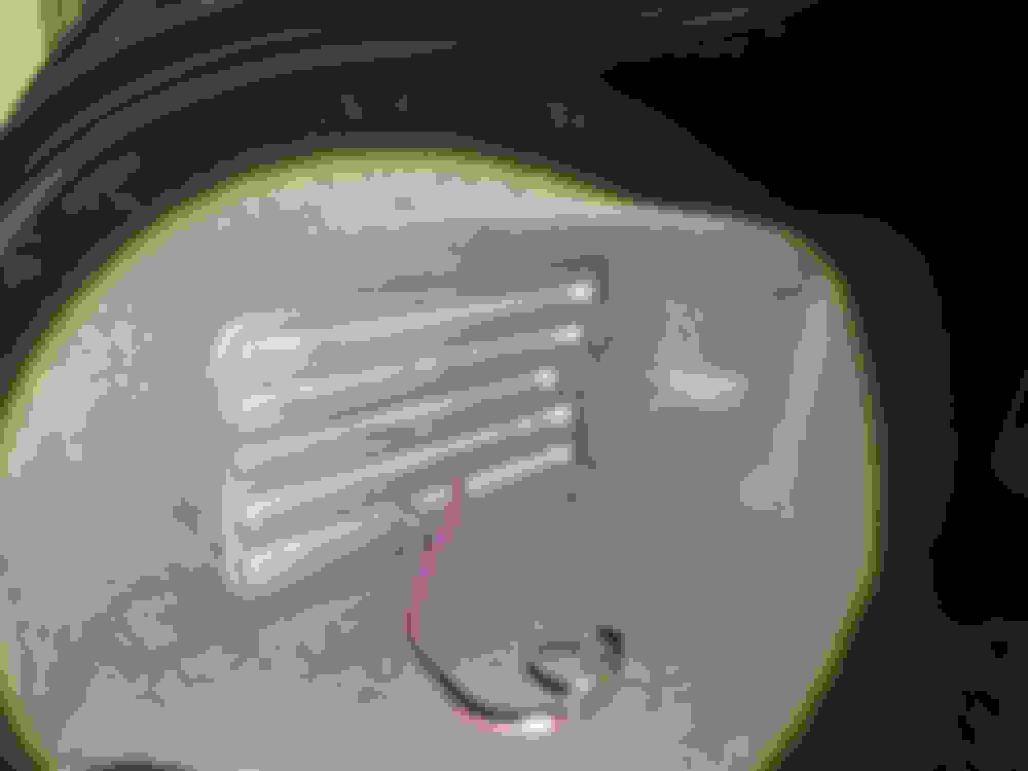

10mm ground, 1/2" socket Pos under little boot.
Look at how nicely it feeds through the vent and caps off when not in use. <img src=" class="post_inline_image" data-size="2000x1504" data-src="https://cimg2.ibsrv.net/gimg/www.jaguarforums.com-vbulletin/2000x1504/hardwirectek_2_6a736c6f9269a43c792383cd6a4b85578eaad7dd.jpg" loading="lazy" />
Wall mount mid-way.
Wall mount mid-way.
Hope this helps someone someday!

I tried hardwiring my CTEK exactly the same way, but when I tried to back the nut off the positive terminal, the whole thing turned. Did you put vise grips or something on the base to keep it from turning?
Old Oct 16, 2025 | 08:19 PM
kj07xk's Avatar
Joined: Jan 2015
Posts: 5,320
Likes: 2,596
IIRC, I didn’t remove the existing nut, just put the eyelet on the post, and added a nut on top. (Could be wrong, but seems like that’s what I did.)
