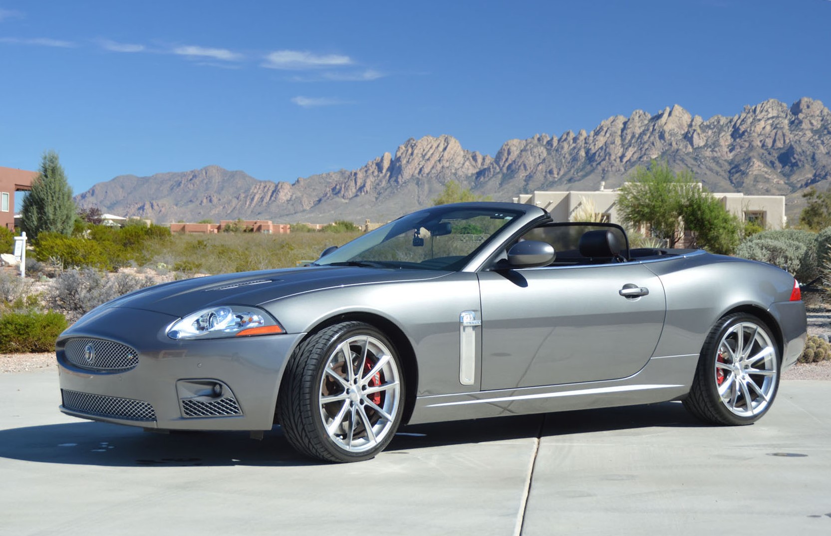

After the hand wash and detail of my Jaguar XKR, I decided to do a quick photo shoot of the "cat" since it looked so nice and clean, shiny and such a beautiful day here in New Mexico. I did a hand wash with new foam sprayer, DA (Dual Action) buff with Meguiar's Swirl-X 2.0, hand buffed the Swirl-X, applied Meguiar's Paint Sealant 2.0 and hand buffed again. It was just under 4 hours to complete. All interior leather conditioned with Lexol. My sports cars are my passion, as they are all fantastic driving machines and works of art in design and function. Click the thumbnail view for full screen images.
Here's my 2009 Jaguar XKR Portfolio Edition Convertible 17,230 miles as of 10/25/2015.

Looks pristine. 2 questions - where did you get the rotors, and how do you keep the exhaust tips clean?
Bruce:
The rotors and calipers are the Alcon UK rotors and calipers that came as an option on the 2009 XKR Portfolio Edition. Since I only have 17,000 miles on the XKR I have not had any need to make any changes so far.
These Alcon rotors 400mm and 350mm are the largest that Jaguar ever put on an XKR.
As for the exhaust tips I use SimiChrome paste polish.
Amazon.com: Simichrome 390050 All Metal Polish Tube - 1.76 oz.: Automotive Amazon.com: Simichrome 390050 All Metal Polish Tube - 1.76 oz.: Automotive
I am sure you can find it in Aussie land. Great stuff for metal.
