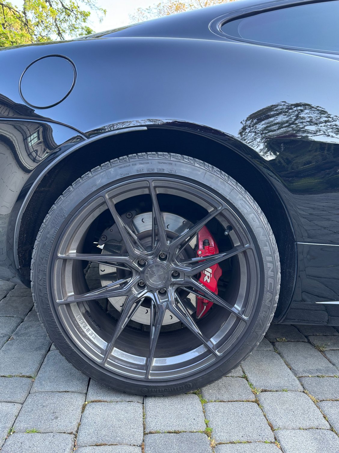

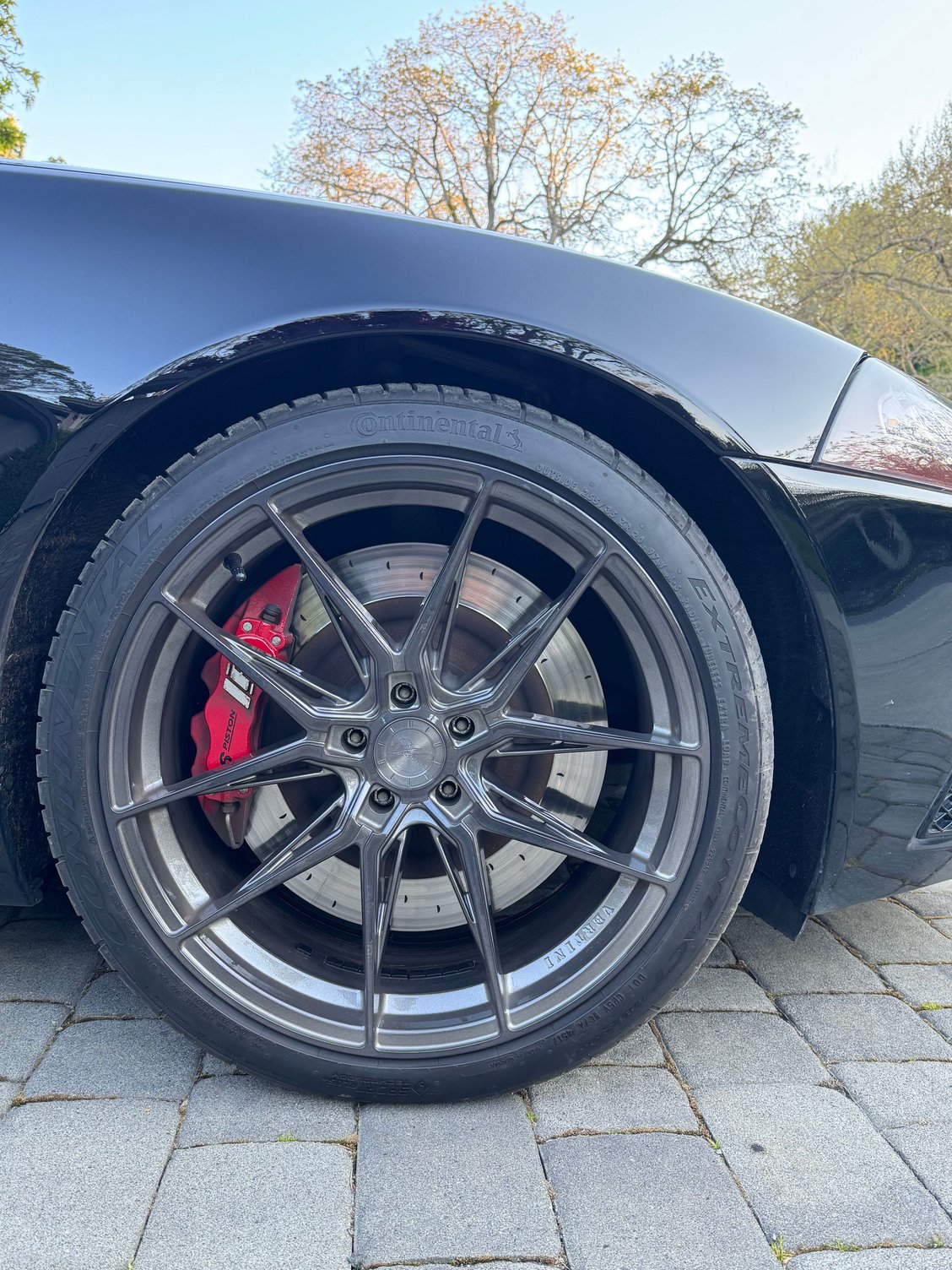

Help with Alcon Brake replacement . I did a search and it looks like you cant get the OEM rotors anymore. Last discussion thread I found was 2022. I need new front rotors and pads im told. the brakes are squeaking like crazy it's doing my head in. Carfax says the rears were done at 80km ( current 94km) at a Dealership in Van that is high end MCL Motors and they look OEM. I will be calling them tomorrow but guessing if the OEM is available it will be $$. also because our brakes are floating ive been told at slow speeds and turning right especially the brakes squeak which is because they tough even when driving ?.
Anyhow main question is what are people in 2025 doing re replacement and are there crossed drilled options ?

Looking at the pics I think there is "meat" left on the front rotors as the half moon/circles are still visible - have you checked what's left on the pads? I suspect the pads are really down.

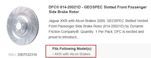

I just ordered front and rear DFC "Alcon" rotors from Carid in da USA
https://www.dynamicfriction.com/
https://www.carid.com/
Drilled and Slotted - part numbers:
614-20022D
614-20021D
614-20024D
614-20023D
Total Cost in US Dollars
Subtotal: $422.08
Shipping: $316.54
Tax: $0.00
Total $738.62
There is probably some duties to pay on that.
