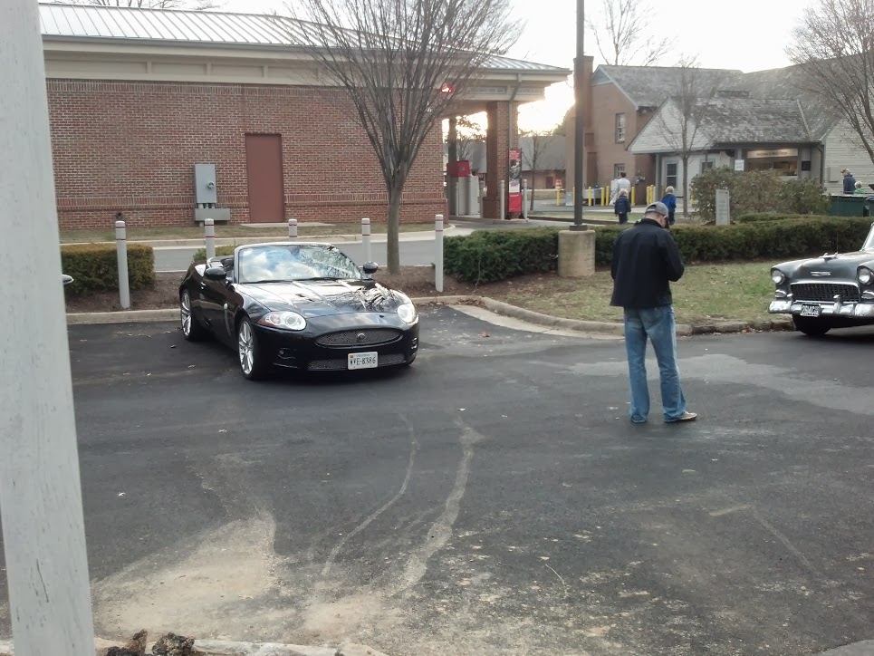

Today is the one year anniversary of my purchase of my '07 XKR! And fittingly, I also hit 60,000 miles today.
What sorts of maintenance items should I have done at this point?
I'm thinking:
1) transmission filter/fluid service
2) cabin air filter
3) engine air filters
4) brake fluid flush
1 year of ownership and I think I'm more in love with it than ever. Definitely the most satisfying car I've had to own, and I've had 10 cars to date.
