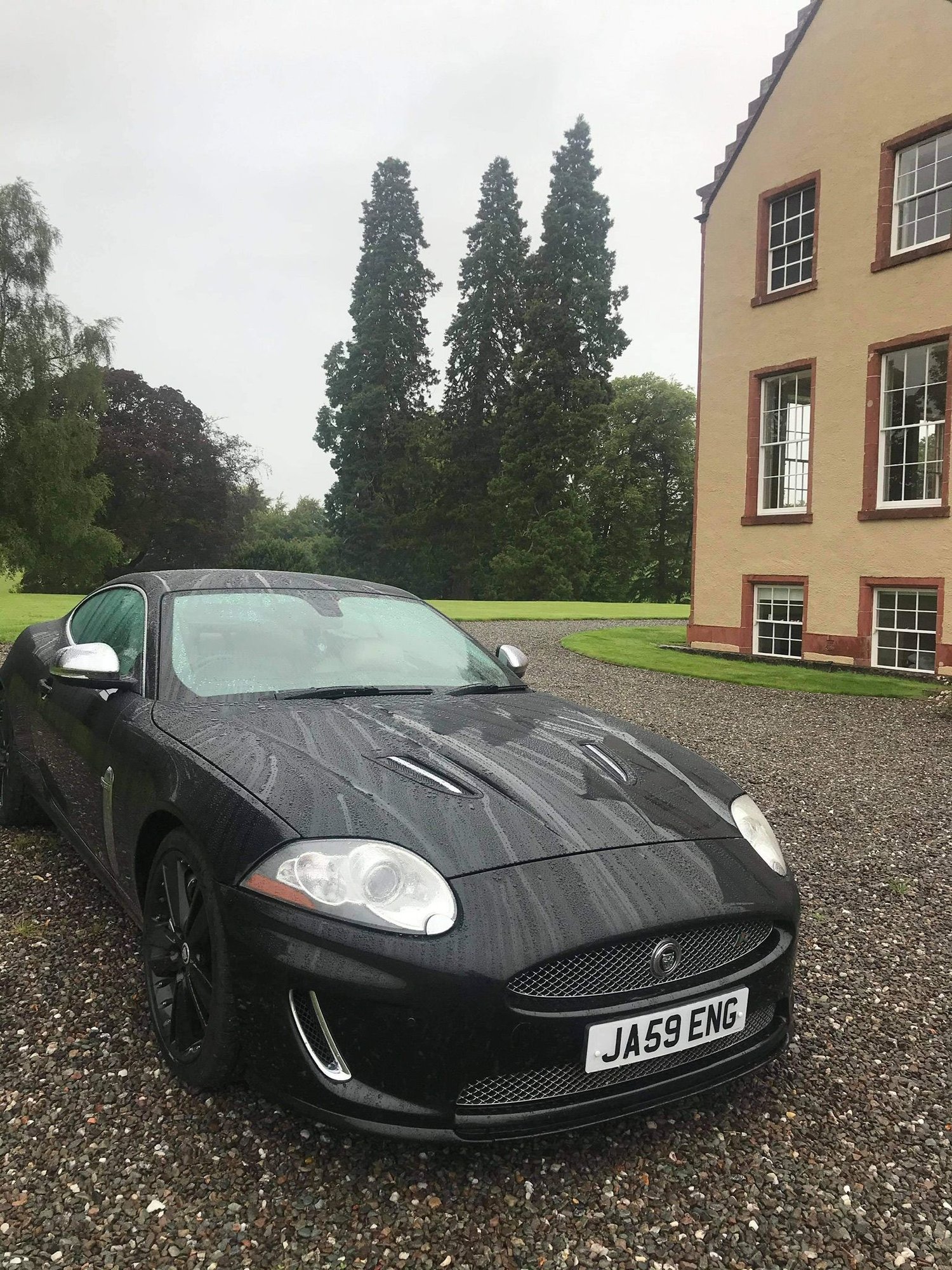

Default We have a runner
Originally Posted by Glasgowjim
Thanks gents.
George, I did call Ali @ Macmillan, he’s booked solid until end of June. I’ve done the plugs and all new coils last week thinking I had it sussed, that’s when I noticed the wet cylinder.
I’m offshore for another 12 days, blocked / open injector is looking like the culprit.
New oil and filter on the cards also.
I’ll post update on here soon as I’m home and back under the bonnet.
thanks again.
Marky, had the car just over a year, it’s at a bad age and has needed a few jobs doing over the last few months.
new intercooler
lower rear suspension arms
2 wheel bearings
battery
front and rear brakes
wheel nuts. (Alloy wheel refurb guy broke one)
rear number plate light housings.
it’s not beat me yet…😂
8 injectors. 8 coils and 8 plugs
lots of smoke, flames and backfires
10 engine management lights
she runs beautifully
Got my car back and over the moon…
thanks forum
