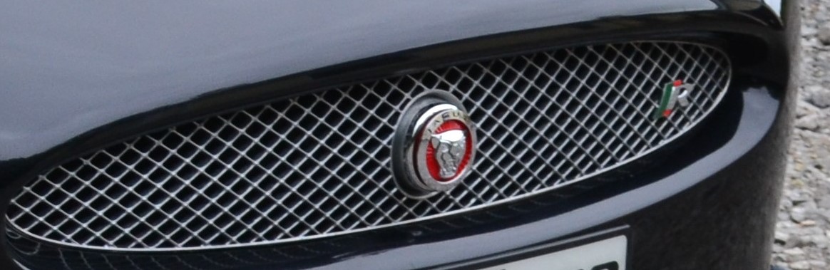

Well decided to give this a go. Bought 2X 85MM CCFL HALO RINGS WITH 1 INVERTER FOR RETROFIT ANGEL EYES HEADLIGHT WHITE, but used one for round my growler badge. Connected it to one of the sidelights wires. Will take more pics as i had to be somewhere else in a hurry so took a quick pic. Have to say it looks nice especially at dust,as the light is just going. I changed the growler from the old dull one to this new type.

OK, now I want that. Got me also thinking.... I want the red part to glow also.
Hmmmmm........ some LEDs, mounted from the rear through holes, fill the red part with translucent red epoxy......

Though of the illuminating the red part before i did it. You can buy what are called led puck lights, which are red 12v. Seen it done on the rear of a jag, but it suited the rear. Would not do it on the front as it would look like a red nose in the middle (rudolf), wouldn't do it. I also have my sidelights switched to ice white leds, also the main bulbs and fogs are ice white, the growler light matches nice.

What method did you use to attach the halo? I'm quite sure I could come up with several ideas myself, but all input is welcomed.
Since I have the older black-background Growler (since enameled red), I had to buy a 90mm CCFL to fit as the 85mm was too small of an inside diameter to fit. Maybe all the sizes are not equal?

Cee jay, my car been 07 came with the old dull green badge. I bought the new red growler one, 85mm as in pic. The old one was just stuck on so came off easy when i got a screw driver behind it. I adhesived the back of the new one and stuck ot on,. The new one sits out a bit, not that you'd notice, about 3-4mm. As for the halo, it has an inside measurement as the badge so just sliped over. I put a wee bit of clear silicone on the inside edge and job done. When buying the halo's some do tell the insde measurement.

OK then powerhouse, how did you get the wiring to the sidelight wiring, and which wire exactly did you attach it to?
I can almost reach exactly ONE plug that I think goes to the headlight of the right, and it has I think eight wires on a nine-pin plug (if I remember).
I will have to fish the supply wiring from the halo through the grill holes and out through a gap between the right headlight and the bonnet support bar.

First when you open your bonnet you will see where the top of your bonnet is screwed on in place, There is a type on ledge in front of it. I drilled a hole in this ledge just enough to let the end leds of the halo to get through. I put the halo round the badge and fished the wire up through the grill to the hole. I screwed the inverter to the ledge and connected the halo wires to the inverter. I had to add a extra piece of wire to the end of the inverter as it wasn't long enough to get to the lamp. Once i did that time to connect. I connected to the right had light. The one plug connects all the wires to the lamp. When you remove the plug, there is three wires horizontal at the base of the plug. The one in the middle is a small black and white one, it's for sidelights. I just sliced into that. The earth i connect to a bolt on the body. That was it.

I ended up removing the plastic trim piece from under the front of the bonnet when it is raised. Thirteen plastic screws and inserts, no holes necessary! Then it is REAL easy to feed wires, and I zip-tied the inverter to a line that goes across the front. Posi-Tapped into that exact wire that Powerhouse specified, and all is wonderful.
Be sure to measure the outside diameter of your protruding Growler, as they are different sizes. The new Red Background one I guess is a little smaller than the Black Background one. Powerhouse used an 85mm light (???) whereas I needed a 90mm. The Growler is actually part of the grill on my 2010, molded into it instead of stuck on.
