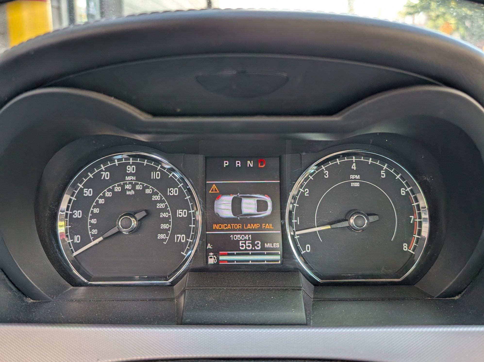

For the most part... I have patched up what issues have popped up and made my way past it - but I can't seem to get past this one. There I was one day driving - go to take a right hand turn, and BAM! Indicator Lamp Failure!

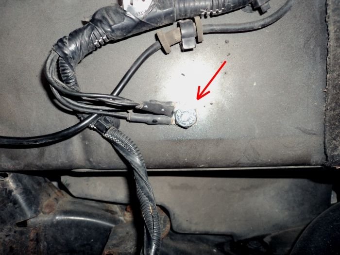

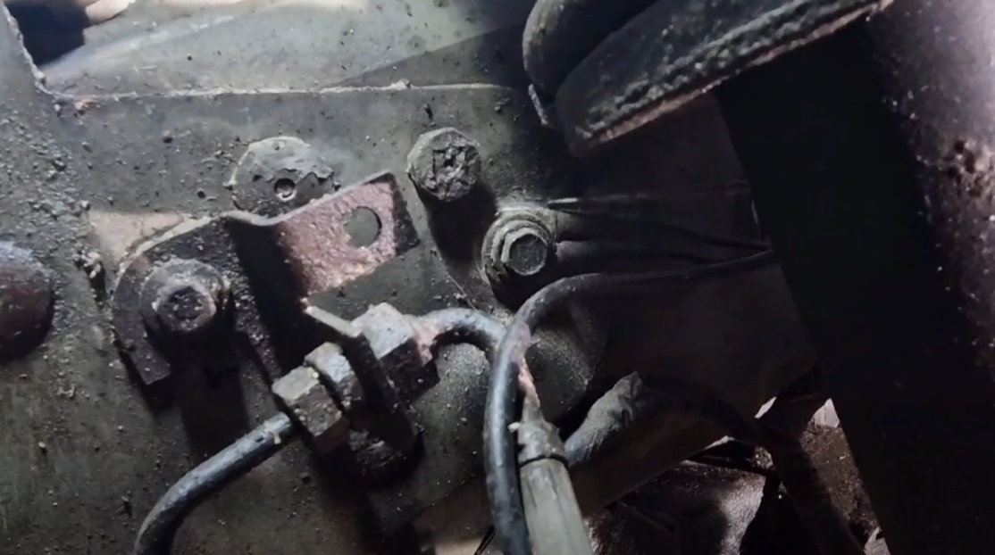

The ground/earth point on the passenger side of the vehicle, behind the strut - did not seem corroded or rusted out or anything weird. I removed it, brushed what dirt and grime was on it - and affixed it back into place. Go to turn the car on.... same issue.

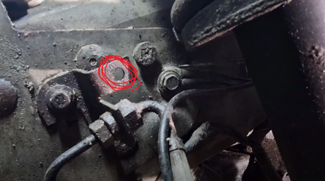

Should I just completely move the grounding point from where it is currently at....
to here? Seen a fella in a video talk about moving his around with a new nut and bolt.. doesnt seem too difficult. It just didn't seem like my ground was the problem though. Totally still could be, I am fresh behind the ears.

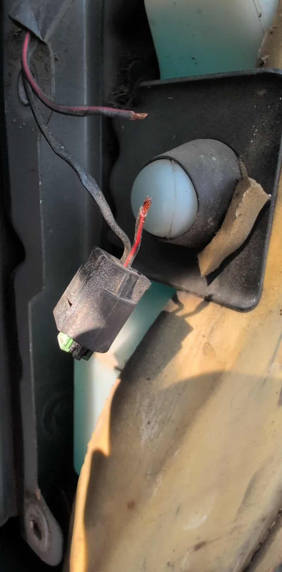

@kj07xk I actually have my front bumper off of the car at the moment - the only wiring that I saw in obvious sight was for these lights:
and the wire stretched across the inside of the front bumper from light to light. This is of course aside from the big plugs that go into the headlights - but that's too obvious. And the headlights work so that big cord hopefully isn't apart of my equation.

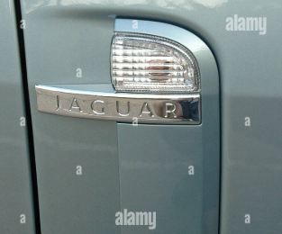

So one more thing I do want to rattle out there - I replaced my passenger fender about a month ago from a wreck a previous owner was involved in. When I put the fender back on - I did not plug the SIDE indicator light back in as I had made the decision in the moment that I would do it later - even though I feel dumb now because it would have taken an extra 30 seconds of effort. Could that plug not being plugged into the side emblem indicator:
be the root or cause of this madness? Maybe a combination of the side indicator not being plugged in + a corroded rear bulb socket / bad ground? I will keep researching and attempting things either way - thank you both of ya

Not having that side indicator not plugged may cause problems with the front (maybe) - I think I can see the side indicator in red on the pic you posted. When I had ground problems with that lug the passenger side repeater on the fender did show up on my display but not the front position as that was fine.

I’m just curious where the access to change that side bulb lives lol.
Old Aug 4, 2025 | 10:56 PM
McJag222's Avatar
Joined: Jul 2016
Posts: 1,451
Likes: 857
From: Vancouver BC
Nothing in the owners manwell, but the service manwell says:
TURN SIGNAL INDICATOR REPEATER LAMP
The turn signal indicator repeater lamps are located in each front fender and can be removed by
sliding the lamp assembly rearwards and releasing the front edge from the fender. The lamps use a
5W capless bulb which is located in a holder in the rear of the lamp housing.

Moved the ground lug that is partially behind the shock absorber - to some random Torx bolt that was screwed in right underneath the original ground location. No change!

Bought a wire brush attachment for my drill so I could really get the thread and ground lugs cleaned off. Everything that has to do with the 2 lugs that ground behind the shock absorber has clean metal contact now and the issue remains.

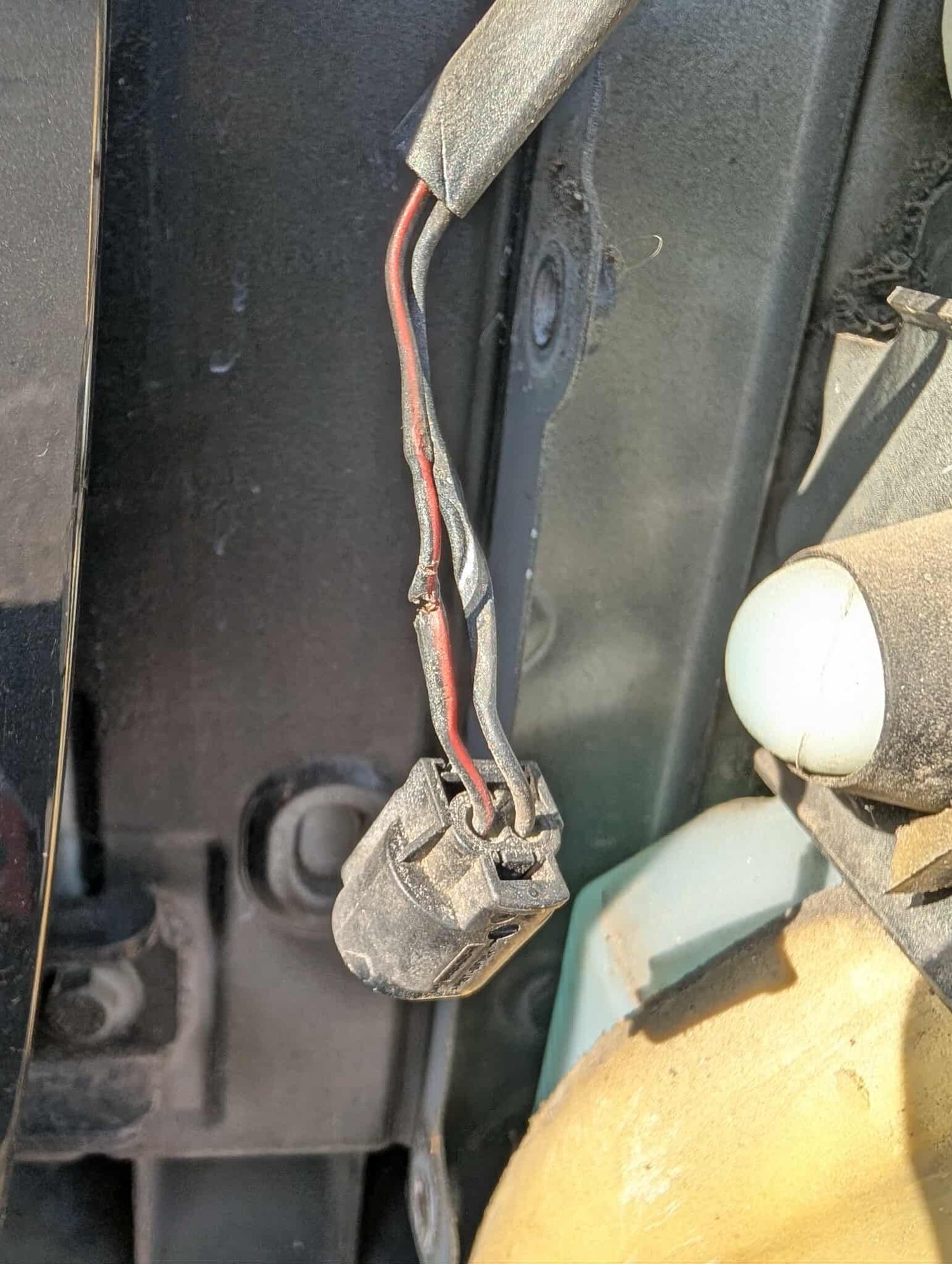

The wires that come off of the 2 ground lugs seem to snake into a bigger wiring harness that go into 2 directions. One direction goes off and becomes the headlight connector cable - and the other direction is at the top of the fender and seems to go backward toward most likely the battery. I did not see any broken wiring or snapped cords or anything that one would deem troublesome. It was a rough draft inspection.... but I just don't know where to really focus my attention. When I was putting my passenger fender back on since the original was damaged, I did not hook up the side indicator lamp. The wire that would plug into the side lamp seems to be pinched pretty rough between something when I shine my light into the fender. Don't ask me why I didn't hook the side indicator up properly, I only realised it recently. Let's just say it was damaged.... do we really think that would affect the whole system? I know it has been pinched in there since the day I put the fender back on.... and everything was working fine for months after the install. There was no dash warning letting me know that the actual side indicator lamp on the fender was not working. Thanks for the read everyone

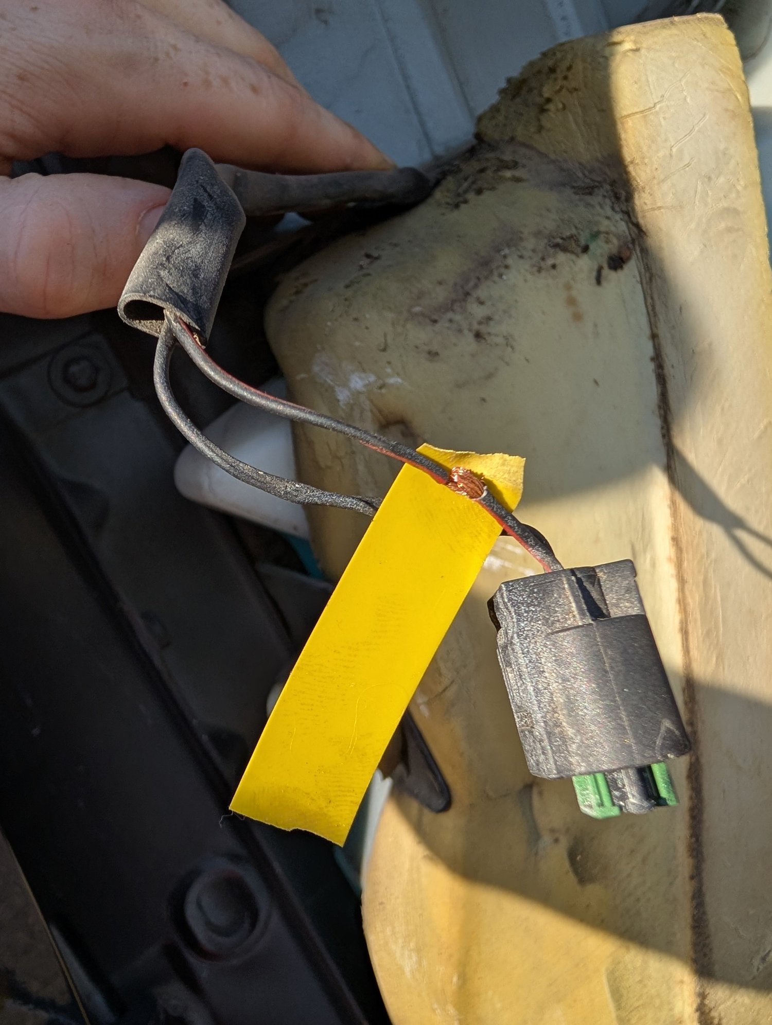

If it's pinched there's every possibility that squashed insulation has worn through causing a partial short (between adjacent wires or to whatever is pinching if it's metal). This won't always blow a fuse but can draw enough current to heat the wire and reduce circuit voltage.
Suggest untrapping the pinched wire.

Ding ding ding.
All working now.
