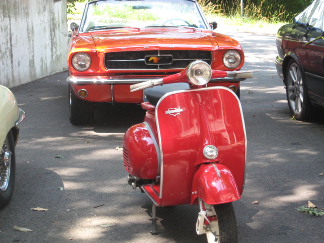

Yeah it's tough, I have to crank, crank, and crank my Vespa, when it sets over the winter......
