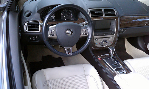

If your XK is equipped with Adaptive Cruise Control, the red triangle warning could be for a fault with your forward alert warning system (that's part of the ACC package). Fixing it could be as simple as clearing an obstruction that's blocking the transmitter. See: https://www.jaguarforums.com/forum/x...-alert-107684/ If your steering wheel has a total of 4 rotary switches, it has ACC and FAWS. Here's a picture of my steering wheel with ACC:
And without ACC:
If you have the Owner's Handbook, it might tell you what that red triangle means.
