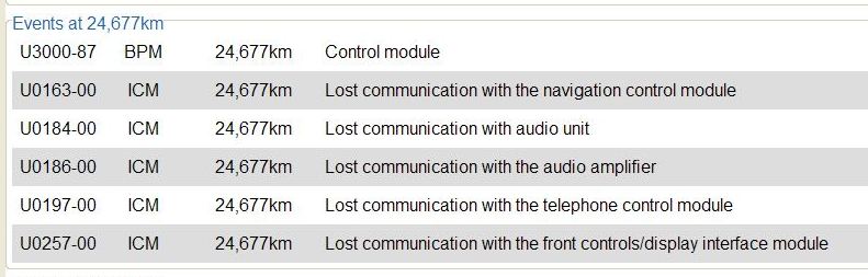

I plugged my diagnostic reader in to the car and found a number of codes which are probably related to my screen freeze.
It looks like the BPM lost contact with a number of modules which I think are all connected via the MOST ring.

I went to the dealer and had a bunch of codes similar to yours pop up. The mechanic told me these cars get those codes and others when the battery gets low or is bad. Seems a bad battery affects a lot of things electronic...
