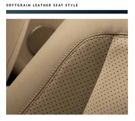

I believe that if you have perforated leather like the attached, you have the luxury interior. The seats will also be 16 way adjustable instead of the usual 10 (extra lumbar adjustment) so there is an extra switch on the seat adjustment panel.
