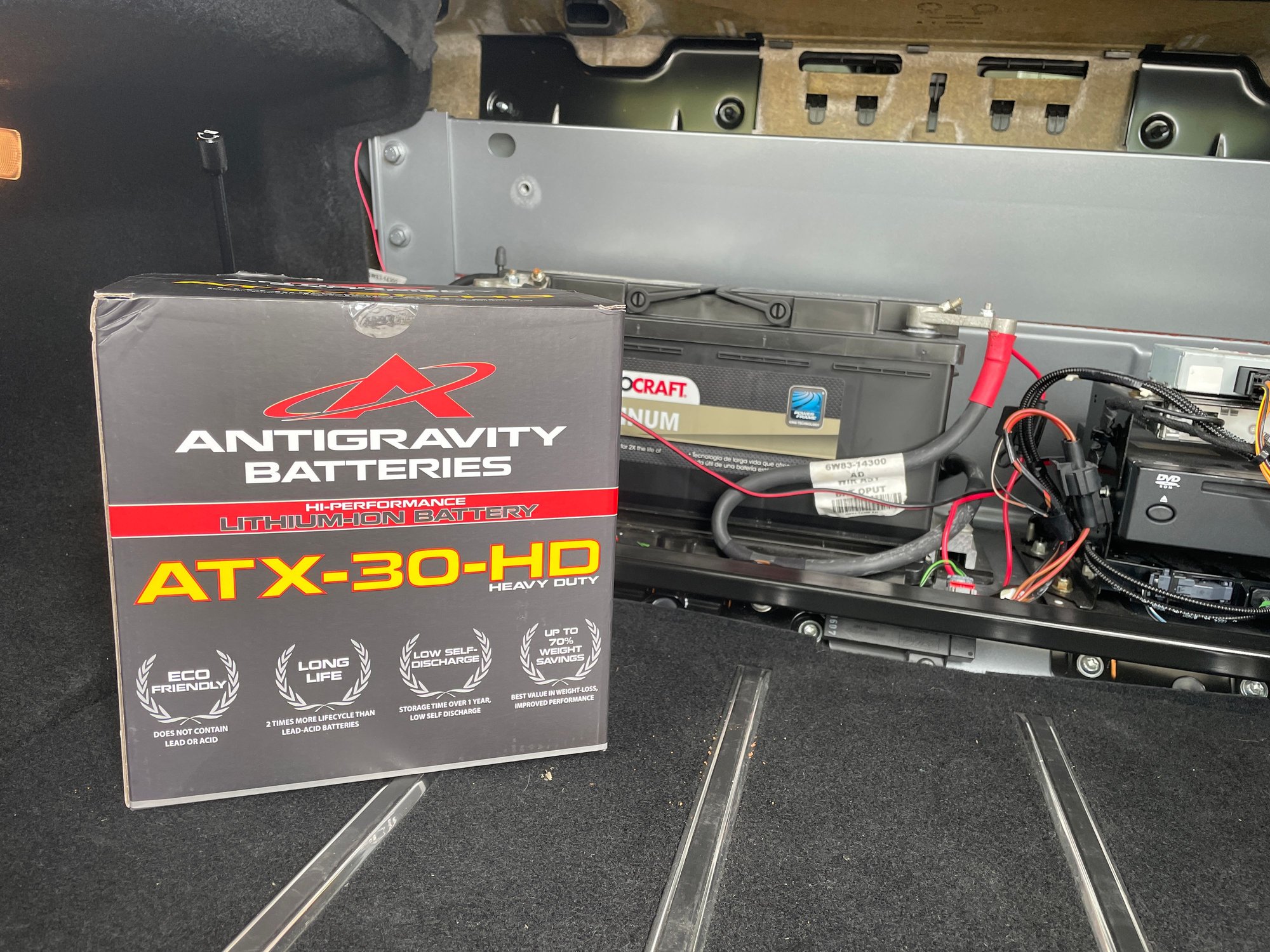

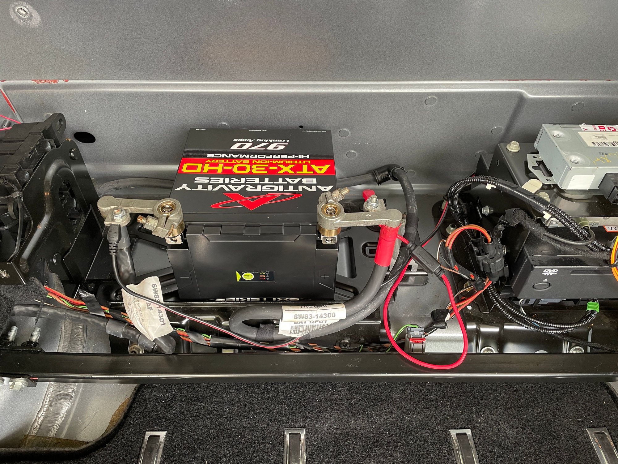

Did a 58 pound AGM/conventional battery conversion to an Antigravity ATX-30-HD 970 cranking amp 5 pound battery. Some on the X152 forums had great success with this and I did too apparently as no problems so far.

No gremlins whatsoever, plenty of power, it just doesn’t have the ‘reserve’ of a larger Ah battery. But for my application that should never be an issue.

Fair question. Lithium batteries have been used for years in McLarens as standard fitment and as optional fitment in Porsche and BMW among others. This is a premium brand product built specifically for motor sports use and has a built in BMS system for temperature and charging protection and for use with any profile type of automotive charging system. However what’s important is the type of external charger used for maintenance.

Follow up to report how fantastic this battery is. Has not been on the CTEK since fitted. Driven rarely and for short distances only until track season resumes later this year. Battery at full charge, all electrics operating correctly, wish I'd done this years ago. Certainly appears significantly more reliable than even AGM.
