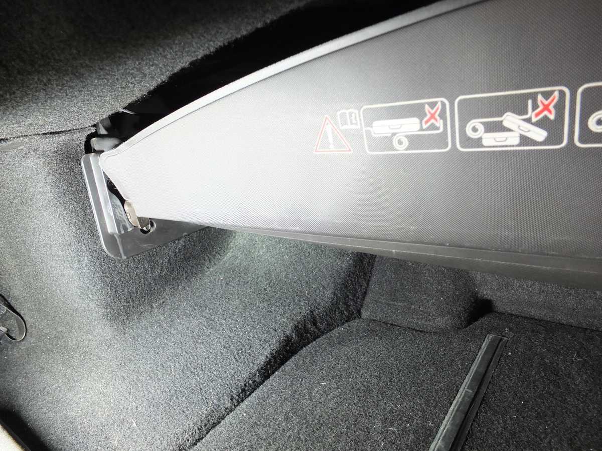

On the leftest-rear-bottom of the slider where it hinges there is a little clip on the curtain that connects magnetically (I think?) a switch in the slider. If the slider part isn't close enough to the sensor in that area it will not activate. There is an entire thread on this whole subject, but the search in this forum isn't outstanding. It's best to use the Googz to search, and that usually points back into here anyway.

Thanks. "leftest rear", on the slider when not rolled out, or when rolled out (backwards) to where it attaches and the last 4-5"s are vertical?

Yeah, specifically on that corner. That has to be completely seated to lower the roof.
wj

Yes, like that. You can see the metal clip on that corner area.

OK, think I got that covered.
