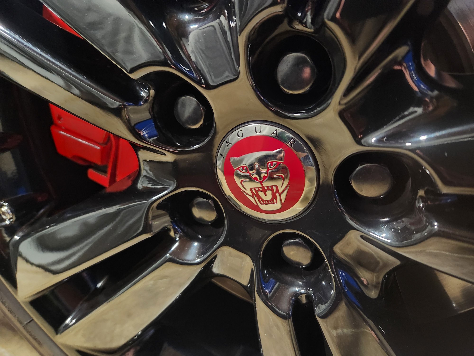

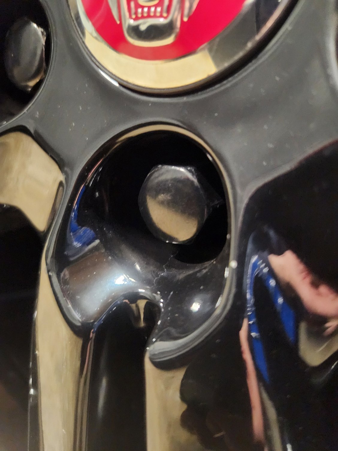

@coldpad1 What is on the car now? Flat or coned?
Old Feb 18, 2026 | 02:12 PM
coldpad1's Avatar
Joined: Mar 2013
Posts: 111
Likes: 6
From: RI
see pics...flat

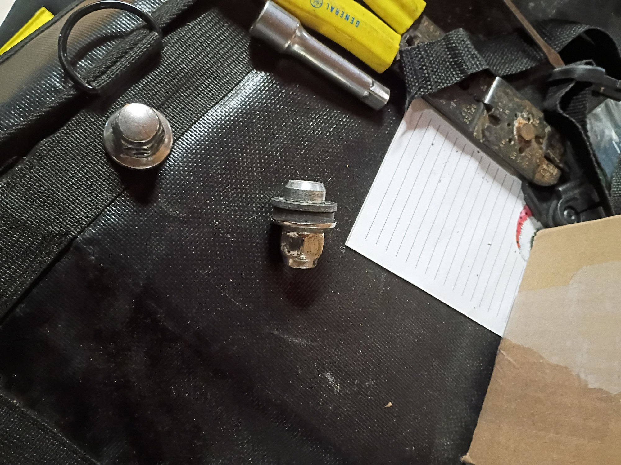

I purchased these Gorilla M12x1.5 lug nuts (19 mm socket) off ebay about 2 years ago, after one of my OEM lug nut caps separated and kept spinning over the base nut (had to take the car to a tire shop to have it professional removed).
https://www.ebay.com/itm/181361451304.
