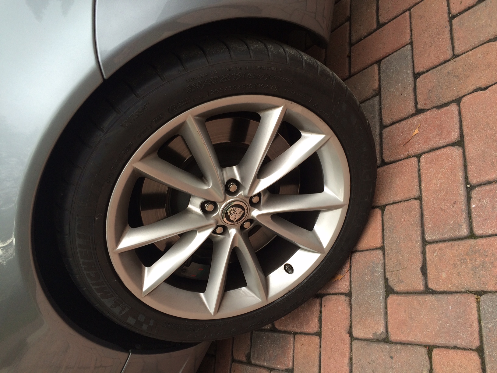

Here's the rear stock 19" wheel of my 2011 XKR with a Michelin Pilot Super Sport 295-35 ZR19 I had America's tire install. Fits fine, salesman said I could have gone to the 305 with no problem.
Attached Thumbnails max width tire on a 19in stock wheel?-295.35.jpg   max width tire on a 19in stock wheel?-295.35-closeup.jpg

logoguy thanks for the real-world example. I might go for a taller, wider tire with the same stock aspect ratio (35) but my question to tire rack was about fitment of a wider aspect tire (30 series), and I imagine that they are accurate in their assessment that a 30 series is too wide for the stock 19 in 9.5in wide wheel. I don't have the tire dimensions calculator handy, but I'm wondering if 305 is getting a little tall and if it would mess up the ABS or speedometer etc. with 305s in the rear it might be necessary to go higher on the fronts to better match the ratio of diameters of the staggered setup.

logoguy, did you keep the fronts stock? I'm just wondering when the difference in stock to aftermarket size ratio would cause problems. Seems to be a 2.1% circumference difference in the 295s that you used. If you had chosen 305s and left the fronts stock, you'd be up to a 3.1% difference from stock and thus difference from the factory "staggered ratio". One solution would be to up the front size when doing the rears, but I'm less interested in wider tires in the front, and troubleshooting fitment there too.
