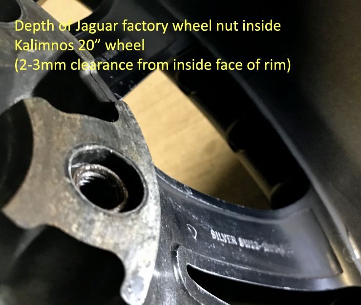

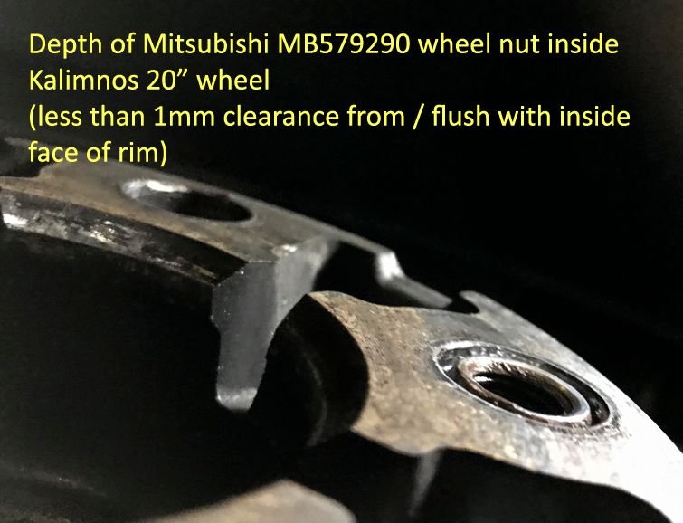

Removing the wheels I compared how deep the Jaguar nuts sat in the wheels compared to the Mitsubishi ones (Mitsubishi are longer below the shank):

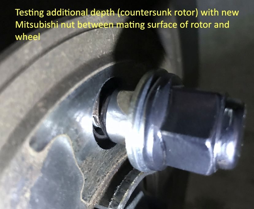

To get a level of comfort that with the various metals involved expanding at different rates these wouldn't end up with the wheels slightly loose (mentioned in the F-Type forum) I checked the depth that the rotors are countersunk for additional clearance:
...and confirmed with a friend who is a professional mechanic who gave it the thumbs up.
Being the CDO person that I am (CDO is like OCD, but the letters are in the correct order) I managed to track down an aerospace washer the correct size to give the extra depth clearance as per factory and have fitted these stainless washers underneath the captive washers on the Mitsubishi nuts:
These (Part Number AN960C1216) are from a company called Australian Aerospace Engineering, their webshop has a US warehouse as well.
