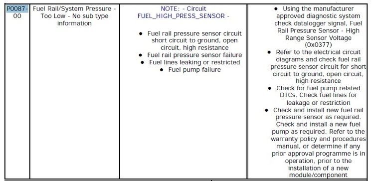

P0087 has no extended codes listed:
An error code is recorded for two reasons:
1. actual fault
2. out-of-range signal
The only code related fault here that could be transient and fix itself is restricted fuel. A circuit or sensor fault or a failed fuel pump won't go away without intervention and repair. If you clear the code and it comes back, you have a harness or component issue. If it doesn't come back, it was very likely just an out-of-range signal.

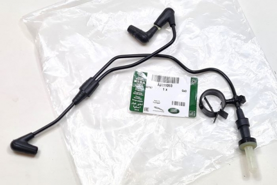

Originally Posted by pbandj
Also noticed this plastic line broken around the fuel pressure sensor. Could that be contributing to the problem?
Certainly would. This is a vacuum hose from the side of the TB to several other locations. Different places on the NA and SC, and I assume on the 4.2 and 5.0, but one is the fuel pressure sensor. Breaks incredibly easily after 10 years in the heat on top of the engine.. Causes severe vacuum leak, and many of the symptoms you had. If any X150 starts running rough, check this along with the top few usual suspects, such as coil and open breather hose, etc. Good news is that it can be quickly fixed with the right size ID rubber vacuum hose from a parts shop. Just make sure there's still a half inch of tubing available near the connectors to push on the new vacuum hose.

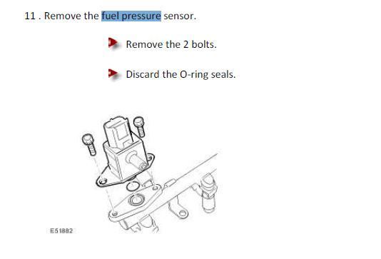

Below is a pic of the sensor. The tube connector sticking out has one of the above vacuum lines attached to it. As I understand it, the FPS has to compensate for engine vacuum to establish correct pressure.
