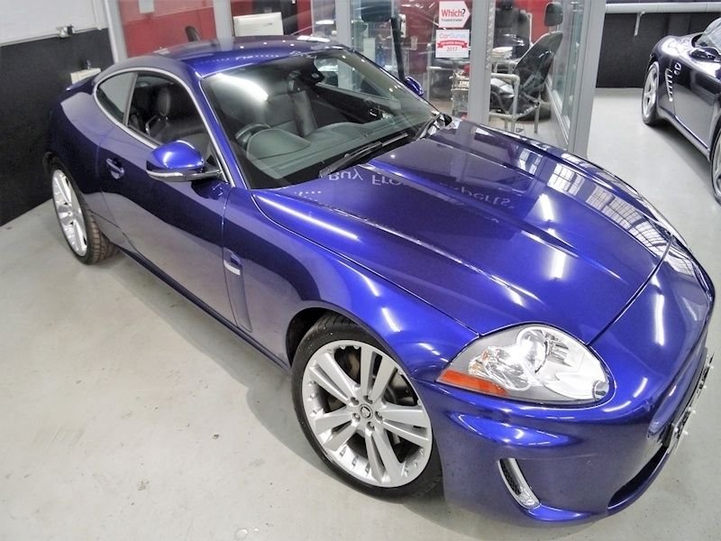

Oh, a picture of the spectrum blue with charcoal I'm getting

Very nice color. When you get it, you'll have to post the color code from the door placard, as 'spectrum blue' doesn't ring a bell.

Am sure you'll appreciate that not all colours are available in all territories, America has a higher percentage of white and silver, purely I think as it's so darned (I'm bi-lingual!) hot that those colours reflect rather than absorb
It's actually funny that you mention red as I've seen couples where one gender is jumping up and down saying ' it's just the colour I want'. The other gender is frowning as how can he...(ooops! they) then negotiate a discount if that's what the other one clearly wants?
When I bought my Audi I wanted an automatic black salon with black leather, however I was clever (?) enough to advise the salesman that I wanted an manual estate with cloth interior and they had to do a hard sell to get me to take it at a £3k discount off the ticket price...he was still rubbing his hands together at a job well done
Paint code for Spectrum Blue is JKM
